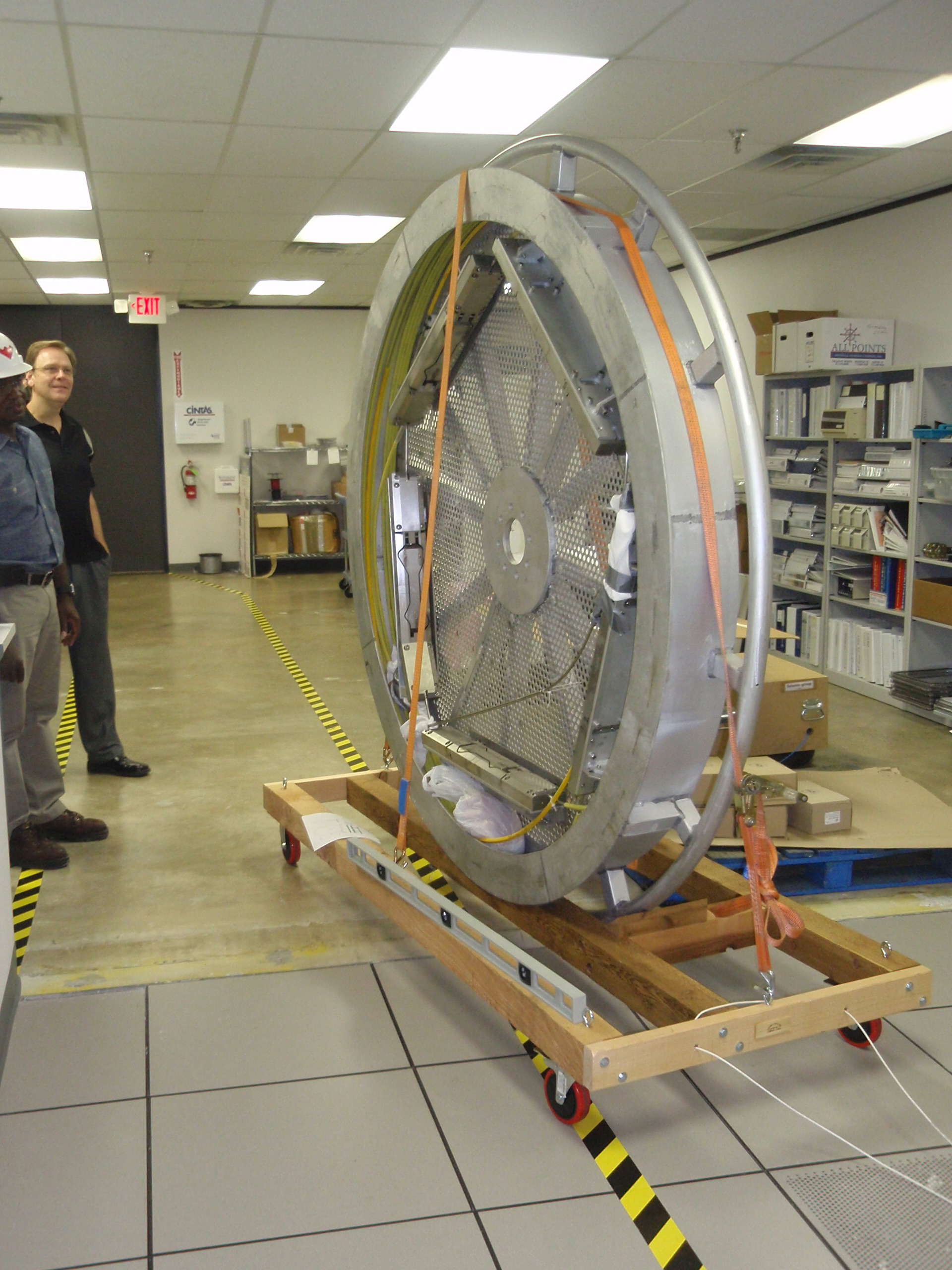

    In the past I made fixtures and risers and small brackets for holding monitors and PCBs and stuff.
    A couple of months ago I had a 800 lb. odd shaped reel that was 7' in diameter and about 16 inches wide that came on four flat wood pallets spliced together.
    I needed to get it to my lab which was down several halls, widest spot 40" and shortest door was 90" - no forklift access. The reel had one flange so it could not sit on a flat surface upright. On top of that I didn't want to take up 50 square feet of floor space with it when done so it had to be stored upright when it got to my lab. I built this at home over the weekend and transported it to the office on top of the Durango we use for carpooling:
    Pretty cool. How did you get it through doorways?
            cart is 36" wide and 7 ft long.
            Reel is 84 inches dia, bottom of reel is 3.5" off the floor. Top of reel is 87.5" off the floor.
            one hallway was only 40" wide clearance.
            Doors you can see in the back are double doors, 90" high.
            Do the math...

              oilfield equipment. this is an array of all-fiber optic sensors, fairly long and rather stiff since it is inserted into a production oil well.
                Do the math...
                Seems like a legitimate question, as there wasn't any math to do. Couldn't assume the doors were high enough, as the math I did up to that point said they wouldn't fit through a standard doorway. But, then you modified the post. So, the "do the math" response seems a bit out of place.

                    • 22109
                    i realized i did not put the correct door height in the original post.
                    I gave the correct numbers and only wanted you to subtract 87.5 from 90... when i said do the math I meant subtract those two numbers... i wasn't really meaning the snide connotation, sorry.

                      that's my point - sometimes its easier to do it yourself than to have someone else make it to your needs or specs. And to do it at home where you enjoy using the tools and the tools all work and you know exactly where they are rather than have to scare up the appropriate stuff at the office/work/school, someone else's place.
                      Fortunately I have a work charge card... believe it or not there's $120 worth of casters, wood and fasteners in that dolly. But 800+ pounds rolled around the office hallways like a dream.
                      BTW, we had a fork lift move the flat pallet off the loading dock, to an area with an overhead crane, we then picked it up with the overhead crane and set it on the dolly and tied it down with the straps to the eyebolts I put in the corners. Then I could roll it down the hallways. Nice to have the right tools...
