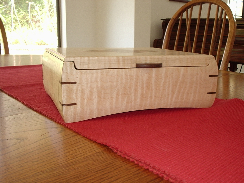

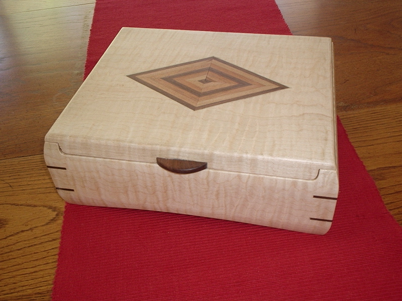

    I'm doing a lot of boxes these days. This is the first one I've done with an interesting inlay, so I thought I'd post it.
    It's curly maple, walnut miter keys and lift tab, and inlay of walnut, cherry, and mahogany. I still need to put in a lining.
Name:	Curly Maple Box.jpg

    All I can say is WOW! You should post this masterpiece on Woodjocks as well.
    Cork,
      Nice lines and shape. I love all of the subtile curves, the wood and inlays make it all the better. It's really beautiful.
      How and when are you doing the shapes?
        That's a real beauty. I'm sure that will be cherished.

          Very very nice box. I love the lines of the project along with the wood.
          Great Job 4est
            After cutting the blanks for the sides, and before assembly, I did the bottom curves on the router table using templates.
            After assembly I made the cutouts for the lid on the front and back using a 1/2" bottom-bearing bit, which brought the cuts right up to the sides.
            Then I used bit called a "furniture/box maker bit" to make the curves on the outside.
            The underside of the top was shaped with a rabbet bit, then a 1/4" roundover to match the 1/2" bit used above. Finally the top side was shaped by hand with a block plane to match the curve of the sides. That's when I made the groove for the walnut pull, but I should have done that before the previous step. It was hard to backstop the cut to avoid tearout.
              Now THAT is sharp looking... Almost a pity to line it...

                That is a very nice jewelry box.
                  Any lining you use is going to be a distraction from a fantastic piece of Maple. The most I would consider is a bottom pad in the individual compartments.
                  beautiful design!

                    That piece is stunning! Great job, JR!

                      Yeah, that's the idea. Maybe a ring holder or two.

                        or perhaps you could make a smaller box to hold the jewelry, and sit this one next to it just to be admired!
                        kidding aside, gorgeous box and great workmanship!

                          Wow, that is a beauty. Whoever gets that will truly cherish it.
                            WOW! I am not surprised though! You do have a talent! That is a beautiful piece of work!
                              That is a beautiful box!
