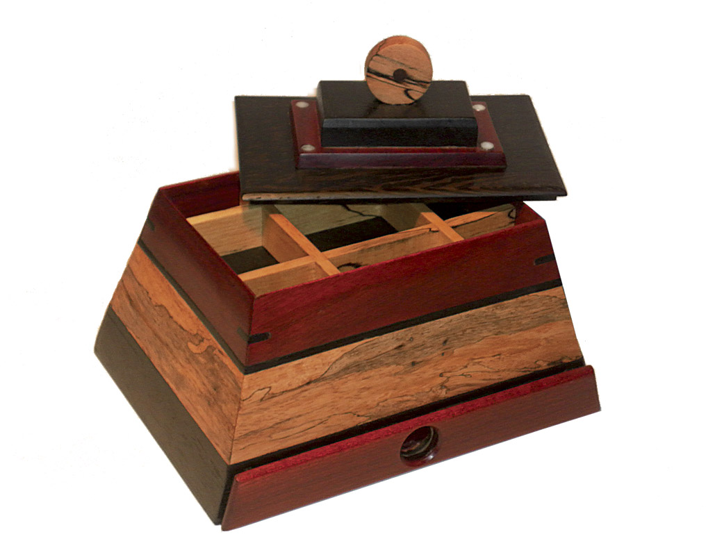

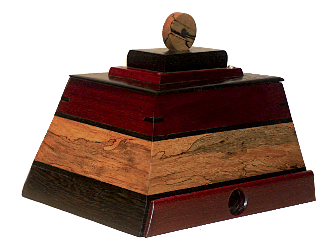

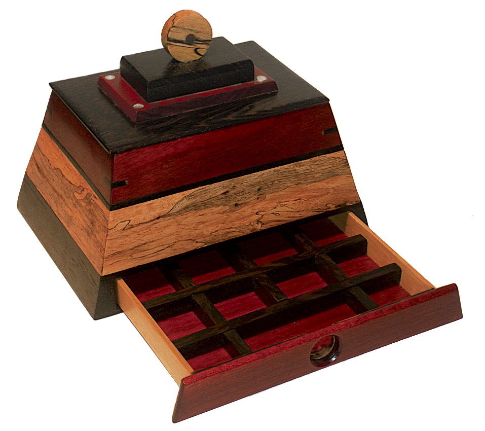

    After making some boxes for my wife and daughter, I decided to make one in the design I wanted. This is the result.
    I used Wenge, Blood wood, Tigre Caspi and good old Spalted Maple.
    The compartments are lined with Black Leather. The finish is my usual, 3 coats of natural Watco, with the 2nd applied with 320 Wet-Dry paper and the last with 600 Wet-Dry. The final top coat is 2 coats of Liberon Black Bison "Clear" applied with 0000 Liberon Steel Wool.
    Making this box almost never saw the light of day. For some stupid reason I decided to make the individual layers as separate "beveled and mitered frames", sort of like cutting crown molding on the table saw and dealing with small pieces to boot.
    Needless to say, a lot of expensive wood ended up in the scrap pile, got enough for handles to outlast me.
    Here's the photos, let me know if my sweat and cussing were worth it.

    BTW, the design is mine this time, although I'm sure that the basis for it came from stuff I saw.

    I glad you perservered Bruce. Wonderful job on the design and finish.
      Very clever and unique. You done good.

        Beautiful piece with an interesting combination of woods. I like the unusual design, too.

          That is a pretty piece of work, Bruce. Kudos!
            Four different kinds of wood (Obviously a project designed and undertaken just to clean out the scrap box), had to use a mismatched wood for the drawer face that doesn't match the rest of the bottom section, didn't even have enough material or money to make/buy a decent knob and had to use a finger pull.....

              Looks great, unique design.
              is there an hidden compartment in the middle section?

                Can I lie and say yes?
                Thought about that, after it was finished

                    Looks like it all stacks up Bruce. You piled up a good one! That has to be one of the most difficult projects I've ever seen posted here and you pulled it off flawlessly from what my eyes can see. Methinks the pile of offcuts you've got left was worth the final piece.

                        Thanks for all the really encouraging comments, they're really appreciated. After living with a project for so long, one loses the ability to discern whether it's good or pukey looking.
                        Loring: I cna neither confirm nor deny the existence os a secret compartment.

                          Very nice bruce. I'm sure you'll love it even more as each day passes.

                            Very cool! Reminds me strangely of a Goa'uld Ha'tak ship...
                              That is just plain cool! I think I have to agree with Gerti about the shape too.
