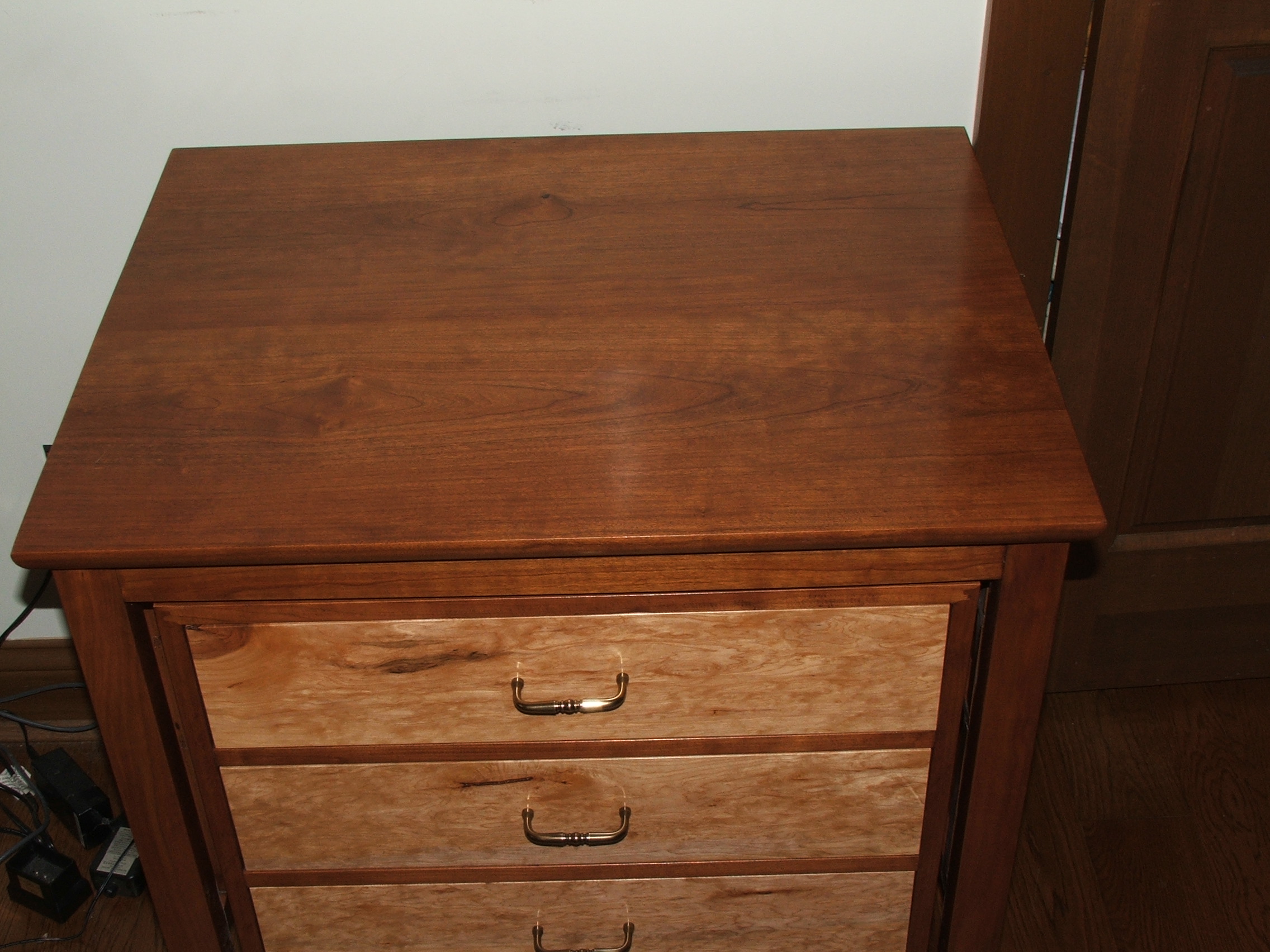

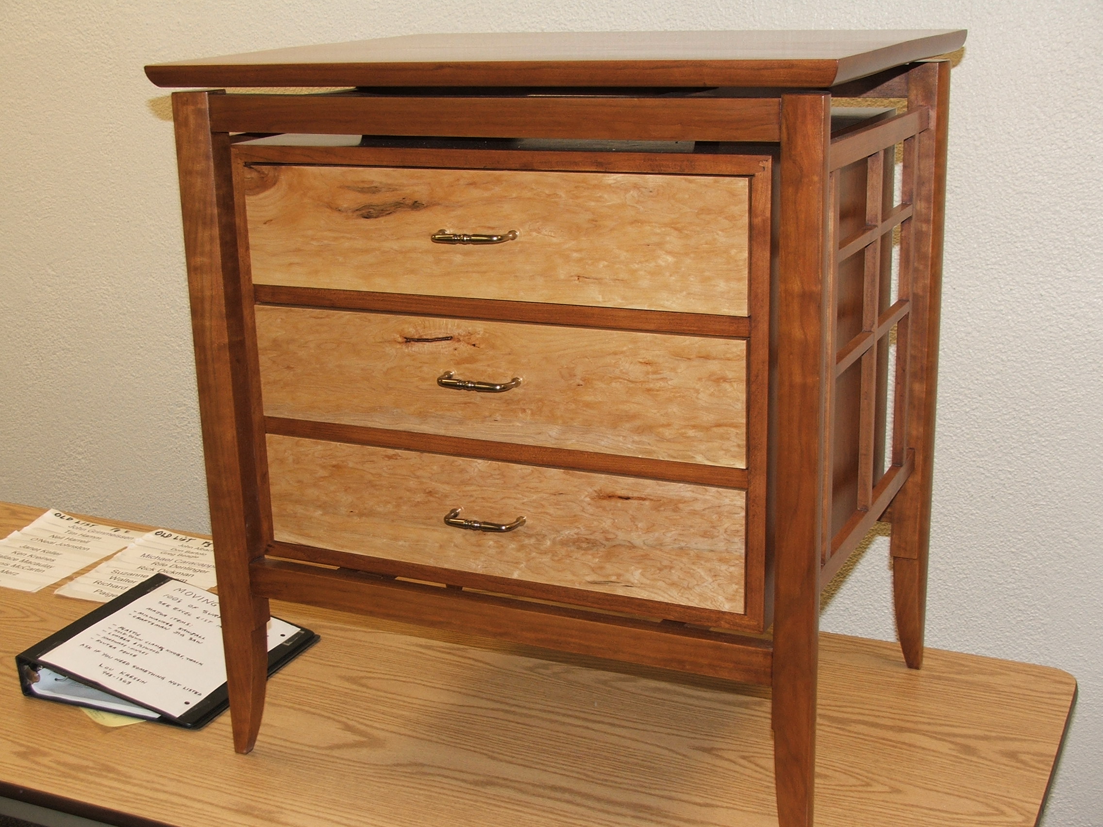

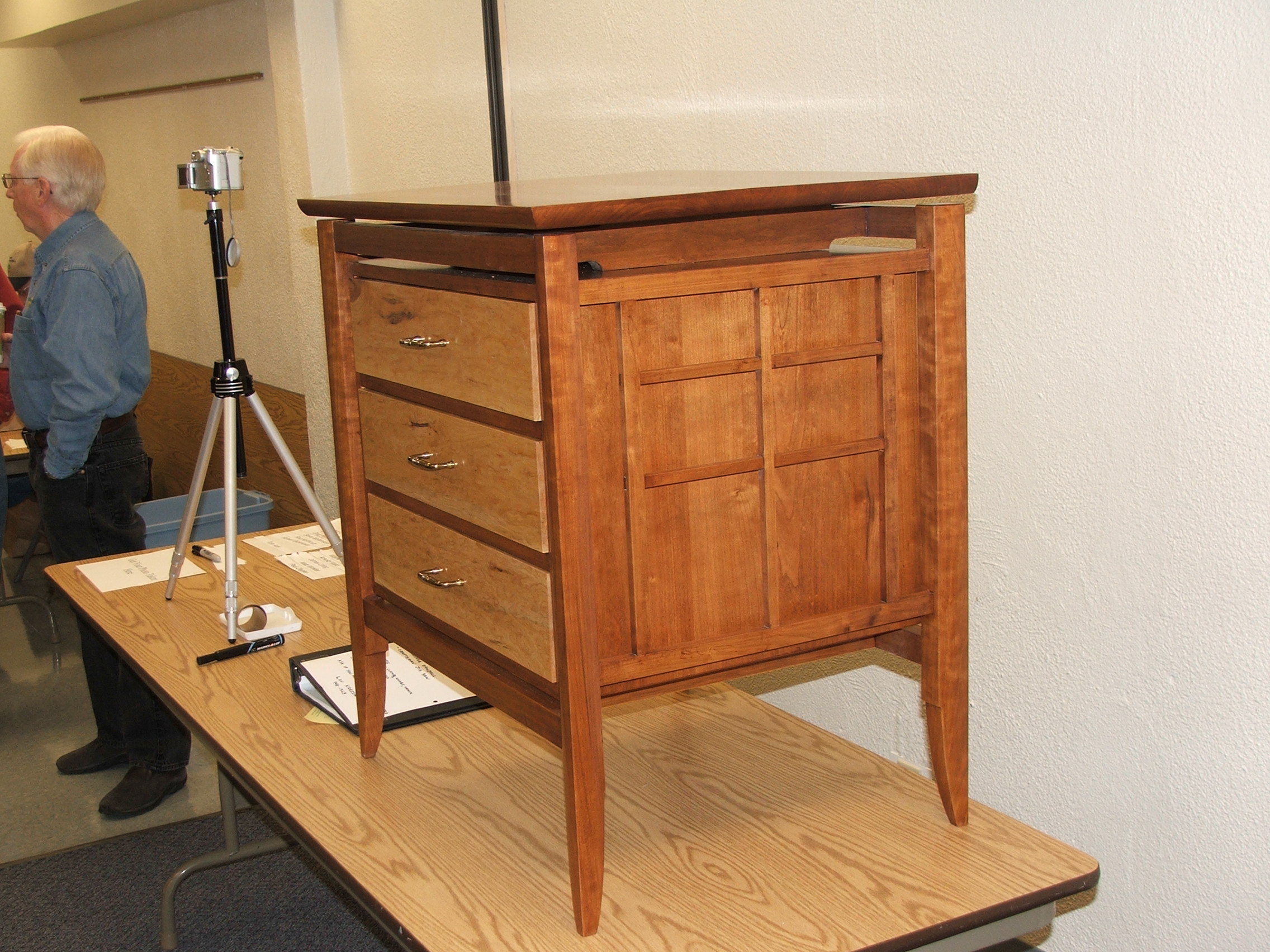

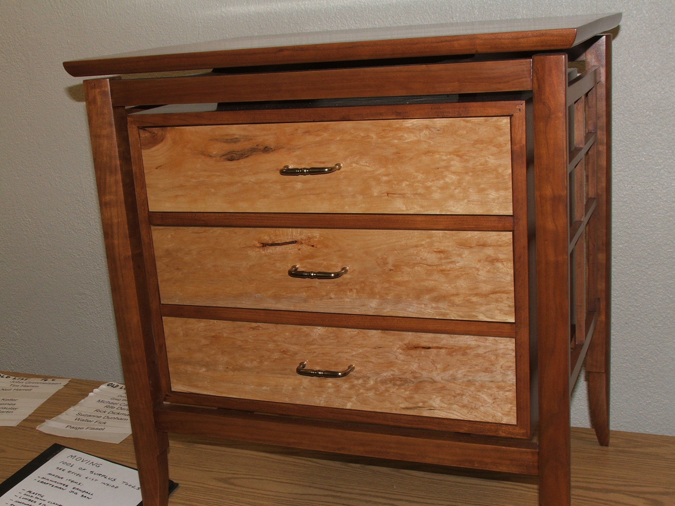

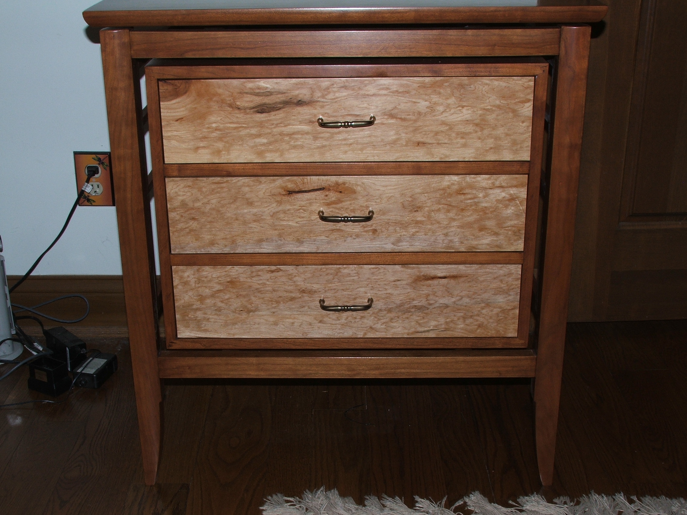

    I plan on using this stand as a printer desk, as most printers lately do not need any mysterious compartments for tractor feed paper or extensive computer connections. The top is about 22 inches deep by 28 inches wide. The wood (maple for the draw fronts and cherry for everything else) was all obtained from trees on my property downed in a windstorm two years ago and sawn on site. It is more or less my own design, with some copying or incorporation of design elements from other pieces I have seen. For instance, the legs are rounded on two sides so that the cross section looks like a rounded diamond shape - this is from Michael Fortune. The main cabinet section floats within the legs and is held in place by stretchers running front to back from the rails. They are hard to see when looking at the stand when standing so the cabinet appears to be floating. Likewise, the top is not attached to the legs but instead is attached to the top side of the stretchers holding up the cabninet at the top. The lattice sides do not touch the cabinet. Drawers are on standard full extension slides and consist of through dovetail sides and front/backs with false fronts of curly/wild maple. I did not know the maple would have such interesting figure until I planed it. The cherry was first coated with shellac and then I applied a gel stain called mission cherry by General Finishes. This was finished with precatalyzed lacquer. I have tried to provide enough pictures to show some of the structure, but they are not the best. This took about 40 hours with the help of a friend along the way. I contemplated some inlay or other decorative elements, but thought the wood was so pretty I couldn't improve on it.

                  Very cool design and execution. Thanks for the larger sized pics. The floating design is very cool on it's own. The curves on the leg faces, tapers and top edges really add to the unique look.
                  How did you do the curves on the leg faces? Did you mortise the stretchers?
                  For the build; did you make the drawer box then build the frame around it, or did you cut everything to high tolerances according to your plans? The spacing around the interior box looks very consistent, and the drawer fronts look to have some tight tolerances too.
                  How is one going to dust the top of the interior drawer box?

                              To answer Erik's questions, the legs started out as square stock. Then I ran two adjacent sides through the table saw with the saw set at about 30 degrees, making sure not to remove the original corner between them. You do not remove much material. Then a few swipes with a plane and a flexible card scraper and you get rounded sides. The stretchers are mortised into the front and back rails. The carcass was built first and the box was finalized in size after the carcass was glued up. Likewise, the drawer dividers and drawers were built before the drawer fronts were trimmed to final size. You do have to pay attention because there are some parts that fit very closely to others.
