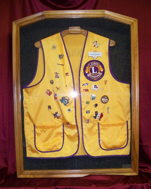

    A very good friend of ours passed away a couple of years ago. Ginger and June became best friends when they were both members of the Bluebonnet Lion's Club. Chuck asked me to make a display case for his June's vest.
    The case and hangar are made from a single Willow board that was given to me several years ago. It had been standing in the corner of the shop waiting to tell me what it wanted to be. As the Willow is a beautiful and graceful tree with the ability to bend when needed, this seemed to the perfect project for it.

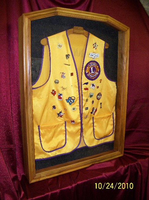

    The case had to be dimensioned to be able to get all the parts from the one piece of stock. There had been some bowing in the wood from not being properly stored so the case sides were rough cut and clamped bowed the opposite direction. It took a couple of months to get them straight enough to work. The top was arched to roughly match the shoulders of the vest on the hangar and, hopefully, provide more visual appeal than a rectangular case. Assembly is glue and biscuits.

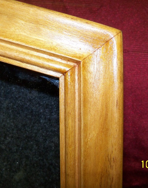

    The face trim was cut on the router table with a molding bit. A groove was cut into the back to fit on the case sides to provide extra reinforcing against warping when glued in place. Double rabbets hold the acrylic front and retainer. Access had to be from the back, made from 1/8" ply covered with a dark charcoal grey headliner material.
    Finish is 2 coats of amber and 2 coats of clear shellac.

    Hey Pappy,
    Very thoughtful and creative. I especially like the 3 piece top section. I am sure it will be appreciated.
    Warren
      Nice job on a deserving project. Love the countour of the frame routing. Going with the arch top was a good call.
      How was that willow to work with? Looks like it has a pretty even grain.
      My dad was big in the Lions Club, they didn't have any women members though. I always thought it was a men's only thing.
        Excellent gift. First I had ever heard of women in the Lions club as well...
          A fine tribute, excellent work.
            Beautiful Don, all the way around.
              Fine workmanship Don. Wonderful "gift" for a friend.
                A nice display case, looks very professional. There's a big market for those for sport jersey's.
                  Thanks for the warm fuzzies, guys.
                  The women used to be an auxillary part of the Lions. As far as I know, the men and women are still separated. The Bluebonnet Lions were all women, but had full membership status.
                  Erik, the Willow was easy to work. Very little problems with tear out. It is a relatively soft wood, about the same as Poplar.

                    Terrific project, and a very nice job with it.
                    • 4estgump
                      • 123
                      • Lawrenceburg, Kentucky
                      Very nice work Pappy. Its great to be able to give a gift like that to a fellow member.
                      Great Work 4est
                      • ironhat
                        • 2553
                        As usual, Pappy, nice project, but the sentiments that surround it make it meaningful. You really are a soft touch, aren't you!
                        Blessings,
                        Chiz
                          Don't be starting any rumors like that...
                          • cobob
                            • 252
                            • Rolla, MO, USA.
                            Beautiful. I'm curious about the hanger. Did you make it also & how did you attach it?
                              The hangar is from the same Willow. The arms are 2 pieces. The center is a cut off from the face trim rabetted to create a slight gap behind the arms when they were glued in place. The assembled hangar is held on with 2 screws from the back.
