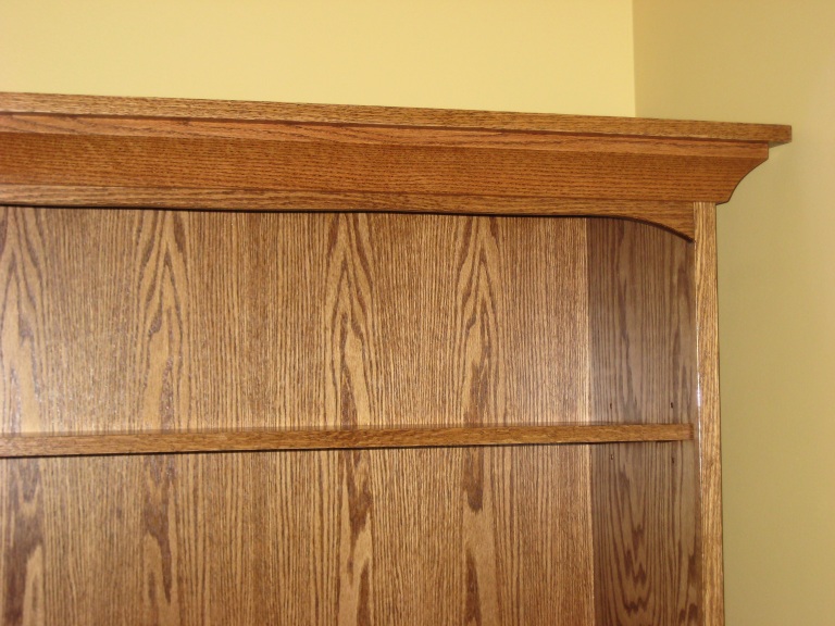

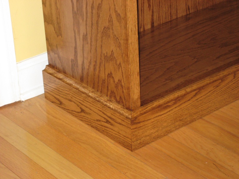

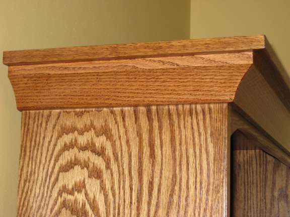

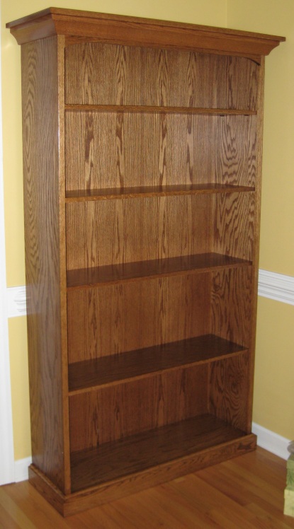

    Do to our book collection growing the previous bookcase I had made has become too small so I have moved it upstairs and made this new bookcase to fit in the space. After taking all the measurements I came up with a nice simple design borrowing from a few different plans that I had seen. It is Oak plywood with a solid Red Oak face frame. The shelves are 3/4" Oak plywood with an inch band of solid Red Oak on the front. I made the top cove molding and the bottom molding out of solid Red Oak, then used early American stain and three coats of satin poly. I do have to say that this one turned out a lot nicer than the first I built 4 years ago, one of the big things I did was use a prestain. I am amazed at how much more consistent the color came out.

    Nice job! I really do like the look of oak. The crown and the curved detail at the top is a nice touch.
    Have you loaded up those shelves yet? I was wondering if you'll get any saging. They appear to be a little less than 48" long, which is pretty long for a shelf.

          i like the curved detail and the crown. Looks great.
            Luckbox, that came out really great. The miters are nice and tight, the staining looks uniform, outstanding workmanship. Good job!
              Ditto on the cove/crown and the curved top frame. Really sets the piece off.

                    That looks great! I've not used a pre-stain on oak and have not seemed to need it however if that is working for you, and it appears that it is keep doing it. I may start myself, it seems it can only help! What brand of early american stain are you using?
                      Nice work Luckbox. I like the grain pattern in the ply, it has nice visual interest, and your finish is great. I've got a couple of these in my future, and appreciate the info on the pre-stain.

                        Thanks everyone. The stain was Minwax. I have not put any books on it yet, the shelves are about 40" so I am hoping that at 3/4" with an inch of hard across the front will keep them nice a strong. I had run some calculations with the sagulator and it looked that it fell within the target range.

                          As mentioned, I also like the grain pattern of that oak. And then the crown makes a strong statement with that pattern. You're going to have some happy books!
