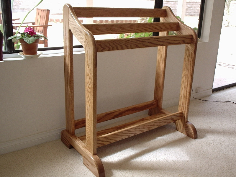

    This is a gift for my sister, who retired last week. She is a very avid quilter and she seemed to really like this red oak stand.

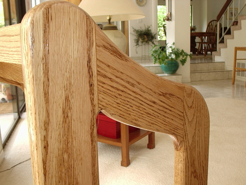

    I have to admit that the opposing 30 degree half laps made for some complicated joinery. I ended up puttying over my failings. This shot shows the most egregious joints. Also note the glob on the underside of the forward curve where I had some tearout. Sigh.
    All the cross pieces are attached with dowels. I have a heckuva time with dowels, but couldn't figure any other way to do it.

    That's a right nice rack. Well done and a nice gift. Loose tenons might have been a bit easier than dowels.

      Nice work.

          I've looked harder at the pictures than I normally would due to you pointing out the errors. I still can't see them. Nice job!

              Looks great. I usually build quilt racks as wedding gifts and you can be sure this design will be placed in the back of my head.

                Cabinetman, I noodled through a number of M&T possibilities, but making mortises on a 30 degree angle with only a bumch of curves to register against just defeated me. I ended up using a doweling jig clamped into place. It actually went reasonably well, but I always find it difficult to get all the holes aligned and drilled in proper plane. I cranked down my clamps to the max to overcome the angular displacement.
                Richard, the rising cross members are meant to display more of the quilt on the rear two rungs. My sister agreed that was a great feature.

                        The curved shape to the top of the ends really drew my eye to them. Very graceful!
                          Very nice job on the initial execution and the recovery JR... did the tear-out on the curve come from using a template and bearing pattern bit? Just curious.. And you mention wiping water based poly. I am within a week of using water based poly for the first time since I around 1998 when I brushed it with less than satisfactory results. I understand they have made improvements in the water base since then.

                            Sarge, I used a jigsaw for that inner curve. The problem is that the half-lap and the curve are meant to taper together, leaving a weak piece a tthe joint. I forget if the mistake happened when cutting or running it through the OSS for final shaping.

                              Thanks for the clarification on the blow-out. I make a template from 1/2" MDF and use an over-head bearing after I draw the finalized template pattern on the piece and cut to within 1mm outside the line... attach template to piece and if you oriented the grain correctly I have never had a blow-out considering the bit is only biting off 1 mm. But.. you had a totally different situation with the joinery of the tapered curves. I would probably have done that with a rasp.. files and spoke-shave.
