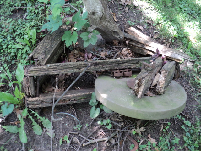

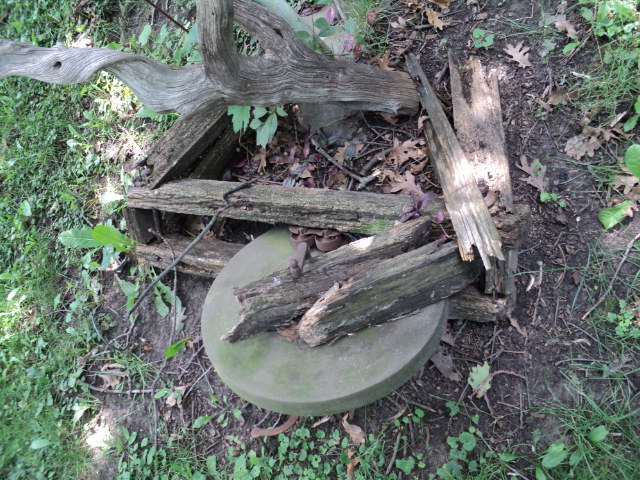

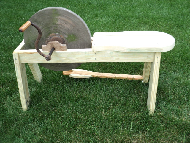

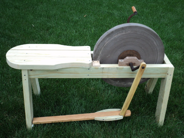

    My neighbor ask me to rehab his sharpening station which originally belong to his great grandfather. Over the years it had fallen into a state of some disrepair. I tried to find something on the net to base my design on but only found metal and no wooden ones. He allowed me artistic license to create something that would make a nice, backyard, lawn ornament. We used treated 2" X 4" lumber for the frame. The pillow blocks are plastic composite decking. The treadle is oak and the pull rod is maple, both with a liberal coat of BLO. It turns easily with the treadle but when I tried to sharpen a cold chisel I found the stone too fine to cut fast. My leg wore down before the chisel was sharp. Fortunately it's just for looks and not for use. I'll stick to my Work-Sharp 3000 thank you.

                          Reasoning
                          The main reason it's "art deco" instead of in use; It belongs to one of my very good neighbors who's into track & field sports, photography and other things not wood related.
                          Other stuff: The stone is too fine to sharpen an axe but would do a reasonable job of putting a rough edge on a wood chisel. On the other hand: The wheel is high in the centre, out of round, wobbles side to side and has high and low spots. (divots) It would require removing about a 1/4" to bring it into relative true. It would give an OSHA inspector heart failure due to pinch points and the possibility of being smacked by the hand crank. I installed a stop block so as to minimize the chance of someone getting injured.
