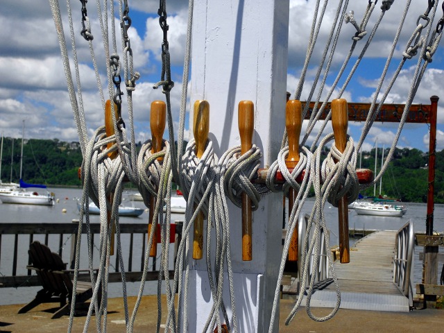

    I belong to a yacht club in upstate NY. It is a working club so all members are expected to contribute time for the upkeep of the club. Normally I'm on "grounds" so I get to rake leaves and pick up garbage for my hours. When they mentioned they needed some new belay pins for the flag pole, I offered up my services on the lathe.
    Then while dropping off some snow felled branches at the village yard-rubbish dump (where they mulch everything into little chips) I saw some 4 foot logs of white oak. I asked if I could take a few pieces and they guy said "You can take it all" pointing to the huge mounds of mulched up stuff. He helped me load it into my trailer (just the oak) cause it weighed about 150-200 lbs.
    I first chainsawed the log to about the right length. Split the oak by hand, band sawed it into semi-roundish pieces and slapped it on the lathe. This oak was a standing tree maybe a week ago so it was a little green still. It was a joy to work with and 6 belay pins later I had about 12 hours into the job.
    Sanded down to 150 and finished them with Clear Shield and then some clear enamel spray. They look and feel great. The handle is 7" and they are 16" overall with a 1" shaft.
    I wish my sailboat needed belay pins but it's about 150 years too new for those Oh well.

                As with most things on a boat, belay pins serve a dual purpose. The are very substantial and I sure wouldn't want to get thumped by one. Plus they are pretty handy when securing a line.
                Here is were these will live out their mulch free lives now. Overlooking the Hudson River just north of West Point Academy.
