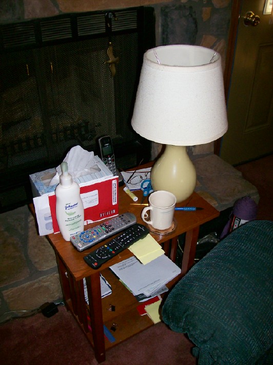

    My wife was working off a tiny table which in essence is her multi-purpose work-bench. Her chair sits at a diagonal to a fire-place hearth which leaves a gap for the table of a osoceles trapezoid. The table must have light.. room for a box of tissues.. letters for bills to be paid and mailed.. a portable phone.. TV changers.. crochet needles and of course a cup of coffee. Doesn't leave much space.
    Her table runneth over to say the least as evidenced in the first picture of the one that is being replaced. A faulty move and the tissue box and letters end up on the floor which I have seen happen many times. So... how to use the limited space to gain a few more square inches in an attempt to serve all her needs in such a limited and odd shaped area?

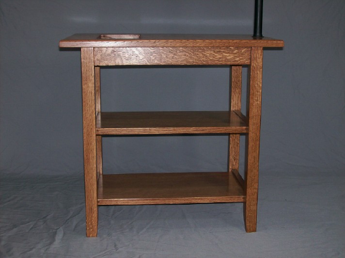

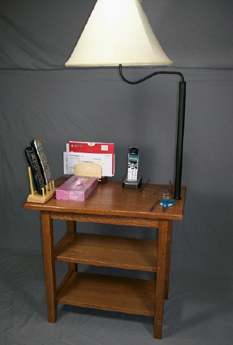

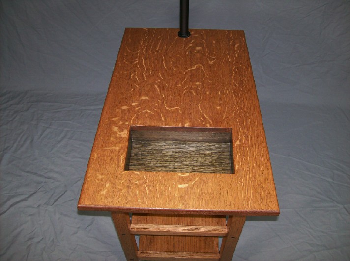

    QSWO... quad-linear legs with QS fleck on all four sides.. ebony pins in bottom shelves to pin non through tenons. The bottom shelves and legs are made of left overs that I culled in other projects. The top is primo I selected as when the bottom shelves are full of pattern books on the bottom and scans of yarn in the middle little will be seen of the bottom. I kept the base retangular but did an osoceles trapezoid on the top to gain a few square inches.
    A plain straight-forward design as I wanted to keep it simple as the majority will be covered as it see's heavy use. I made a few do-dads for the TV changers and letters to avoid the many spills that have happened. There is a drop hole to make sure the tissue box doesn't slide off again. Not a difficult or fancy build but.. one that was well needed. Very well needed IMO.....

                That's pretty sharp looking. Love the grain on the top. Your photography skills really help to show off the piece.
                How'd you handle the cord for the lamp? Is it just hanging or did you conceal it in a leg? Nice match on the flea market fixture. It works well with the piece. Straight lines with a little curve matching the large curving flecks in the top.
                How do the shelves attach to the stretchers? Do they fit into stopped dadoes on the stretcher?

                    The cord originates at the base of the lamp pole of course Pelligrini. I simply wrapped it around the corner to the back side next to the fireplace and dropped it down the leg to the floor where there is a carpet seam butting the fire-place hearth. You can't see it from the front when the table is loaded.
                    In the case of the picture I twist wrapped the cord underneath and duct taped it up. Then made sure I chose angles that it would not show in the photo. In other words I photo cheated ya with an illustion. And yeah... the shelves are attached with stopped dadoes to the side to side stretchers. I allowed an 1/8" on each side short of leg for expansion. QSWO on a piece that size sealed will normaly move no more than about 3/16" seasonally from my experience using it.
