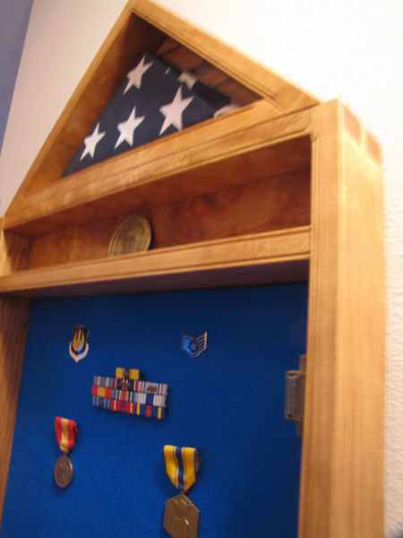

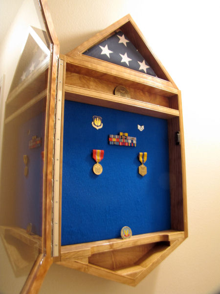

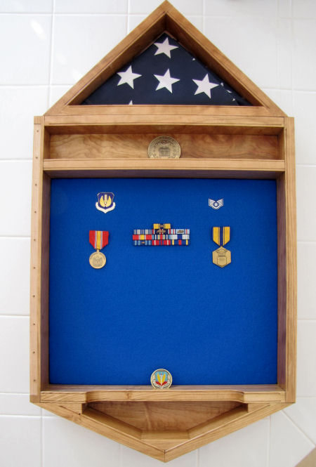

    Our son, Earl K., who is making a career in the U.S. Air Force, was recently promoted to Tech Sgt., and needless to say, I'm very proud of him. I have been looking for an interesting design for a flag/award case that will house his retirement flag in a few years as well as ribbons, medals, and challenge coins he has or will receive. I ran across one several months ago. Having done a lot of projects having straight lines and square corners over the years, I thought it might be interesting to tackle some curves and more complex angles. This piece REALLY provided that challenge, and, in fact, I nearly dropped the idea several times during the project. It didn't really seem appropriate though to give up and buy one, so I stayed at it. Finished this week, my wife and I will deliver it to him in Atlanta.
    The case is solid cherry. The design as adapted features a door in the shape of an Air Force enlisted chevron. Five segments are joined as a face-frame using double biscuits. It is mounted using a 20" piano hinge. One magnet catch holds the door closed.

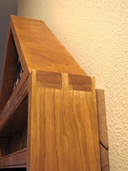

    The main case is basically a rectangular frame box (through-cut dovetails) with triangular sections added to the top and bottom. The main display panel is cork bulletin-board material laminated to plywood and covered with blue felt. This makes it possible to "tack" or use velcro for display of items. There are 2 grooved shelves for coins and medallions and an additional space at the bottom for a small cup, etc. Overall size is 35" X 19"; depth 3.75".
    The finish is several coats of tung oil and a coat of Johnson's paste wax. It mounts to the wall using a French cleat.
    Needless to say, this was a labor of love and pride. I'd be interested in any comments, criticisms, etc. Thanks for looking!

    How did you do the curved glass for the door?

        I made a pattern and took it to our local glass shop. They cut and installed it for me.

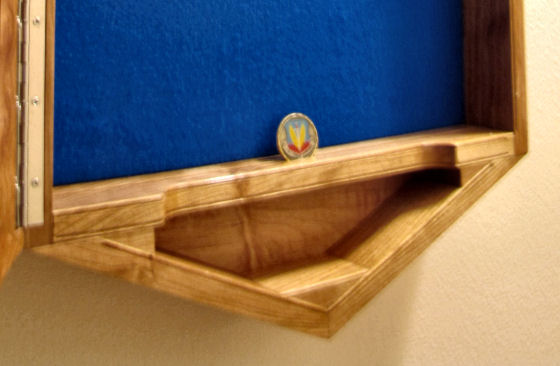

                            I've been hit'n'miss here of late, so just seeing this first time today - glad its been bumped. Love the grain you chose in that cherry, and the finish is outstanding. One question - in this design, what is the purpose of the small space near the bottom?

                              Great question! The bottom triangle functions primarily to support the curve of the bottom of the door. This curve is an important feature of the Air Force chevron. The bottom wedge provides a flat surface on which to place a small cup, etc., and it, along with the two wedges at the sides of this space strengthens the total glue joint of the bottom of the case. The shelf above is shaped to allow more height if needed. Thanks for the comment.
