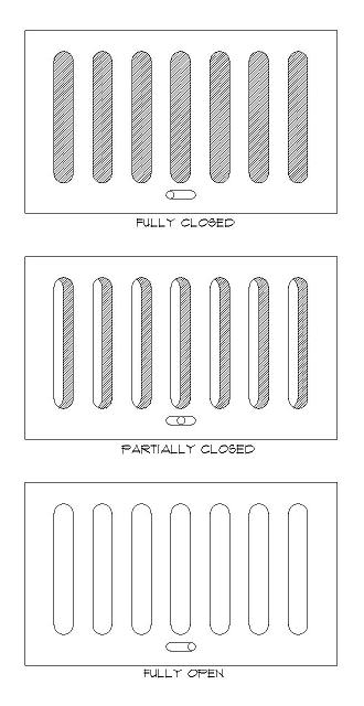

The floor was 3/4" cherry hardwood. No they don't have the dampers. I had thought about trying to add them but I was told that they didn’t use them on the old vents and weren’t interested. Still would have liked to try to figure out a way to have included them.
Floor Vents
One easy solve for the dampers, albeit one that doesn't provide directional air control, would be a panel below the main grille that has the exact same cutout pattern, and a slide mechanism that lets you move the sub-grille an inch, so that it either blocks the cutouts (partially or fully), or disappears when they are wide open, as in the following diagram:Comment
glue?
Excellent idea.
What kind of glue you used to join the two pieces before routing on them? Just yellow glue?"The course of history shows that as a government grows, liberty decreases"....it happens the same with a big shop.Comment
