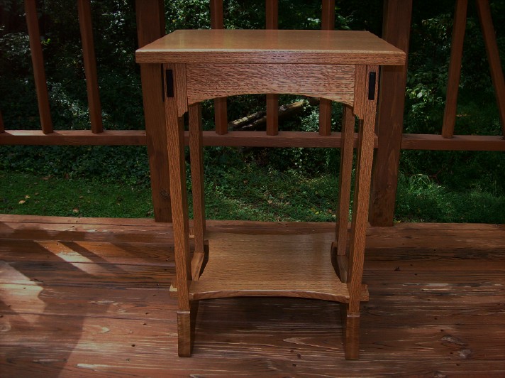

    Sarge, that's really nice work! I especially like the cutouts in the legs; it lightens up the legs nicely. Nice accents with the ebony, too.
    g.
    Thanks G. I like the cut-outs also. I have never seen any used in that manner but.. I visualized them to take some mass out of the 1" thick.. 23" long legs to tone them down a bit. I will probably use the concept again when the time is right.
    BTW.. interesting note. I cut the square holes with my industrial mortiser.. drew straight lines between them. The intension was to cut the line to the inside and finish the rough cut-out with a bearing bit in my router using a template made of MDF. But.. the ole trusty Bosch barrel grip paired with a T308B Bosch blade (the Extra Clean) left such a smooth cut on the line the router bit and template was not necessary.
    I suppose I can hold a steady line as the line was dead straight in that 1" stock.. no burns and extremely smooth in the oak. I quick ripped a 3/8" x 3/8" piece of stock.. wrapped it in 120 grit and made a few passes on each side. Then used the final 180 grit for a few. Done without having to use the router which was really a surprise to me but a welcome one as it saved a few normal steps.
      Sarge, can you give us its total dimensions? What type of printer is going on it? (something heavy like a laser?)
      I really like the looks of that, but would probably need to add a false compartment for weight in the bottom for my project (brothers printer).

      Thanks sir.. I will attempt to answer your questions. If you any additional ask and you shall recieve.
      Top.. 1 1/8" thick..20 3/4" wide X 17 1/2" deep. Base.. 1" X 5" X 17"
      Legs.. 1" X 3" X 23 1/2"... Stretchers 3/4" X 3 3/4" X 15 1/4" front.. 3/4" X 8 1/2" side and add tenon depths on each end of course
      Her little HP printer is not heavy. It will set on top and is 18" wide.. 16 1/2" deep. The small shredder is 7" X 13" wide X 15" tall.
      Dimensions may be an issue with your larger equipment but.. I can assure you strenght would not be. With 1/2' X 1" mortise and tenon.. bridles the same and pinned through tenons on the bottom... I would be very comfortable lowering a 1000 lb. engine block on that table to work on without the slightest worry about wracking it.
      "She" probably worries that the table can withstand very heavy weight as "she" knows I might just borrow it while she is "out" to do just what I mentioned with an engine block. She'd kill me but.. I been killed before so...
      Again.. any additional info.... ask!
        Very beautiful Sarge. Are the tenons ornamental or is it an actual wedged joint?
        Thanks Richard.. The top ebony accents are not through tenons. They are strickly there as "icing on the cake" to decorate and add visual appeal. There are actually real mortice and tenons on the front stretchers which are 1/2" X 3" X 1" deep. The side stretchers tenons are 1/2" x 3" x 3 1/2" as the mortise is full (open on top to allow more glue surface) which technically creates a bridle joint or what I refer to as a saddle joint. Depends on what neck of the woods you hail from on that call.

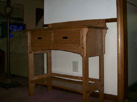

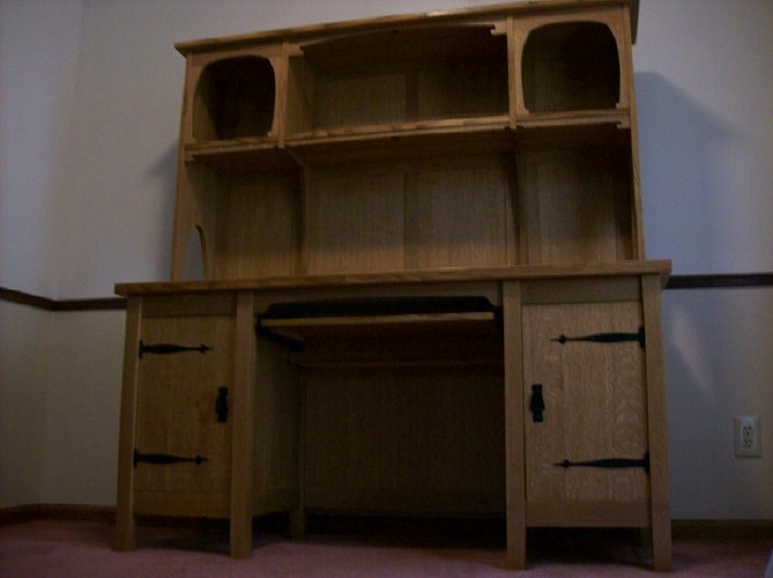

            Doesn't look like Miss Thompson is willing to give anything up at this point, Pappy. She appears to be elated with both her bedroom and her new study furniture. I was goint to take a break as I have had the pedal to the metal for two years building for her. She had agreed to that so Xmas gifts was going to get the call while the Furniture 500 was under caution laps.
            But.. I got on her nerves so bad yesterday with boredom from completion of this piece she told me this morning.. "maybe you should go get more lumber and get outta my house and into the shop". Appears I may have played my psychological war cards j-u-s-t right. I may take her up on the generous offer even though the budget said wait until after Xmas.
            So.. here's teh pieces you'll have to ask here about....

              Wow, beautiful work, Sarge. I also built a computer desk for my wife recently, but it was much less design-intensive, just painted pine for utility's sake. Yours will definitely be passed on!
                The ebony accents look great, Sarge! They complement your wonderful table.
                I've done a number of similar accents in the past,, but I always wrestle with them. A craftsman purist might balk at something that is there only asa design accent, and not a product of the joinery. But all the great designers did it.

                  Nice work Sarge. The pieces aren't exactly the same in design element but compliment each other nicely. Whether intended or not that is very hard to accomplish.

                      Thanks JR...
                      In the last year or so I have made an effort to do my homework with design which I was lacking the knack for. I can say the same thing about finishing until about 10 years ago when I decided I was coming up a day late and dollar short on every project. I have mainly focused on A & C.. and Art Nouveau as I like design elements from all of them.
                      So.. my designs are hinged between country.. A & C and a touch of Art Nouveau as I do use a number of curves and cut-outs much as an architect would in a building. I like my furniture with curves just as most men like women with them.
                      So.. it matters not to me about purist as I could never be accused of wearing a halo I suppose. But.. with that said, I want my pieces to be pure... pure Sargenskil (Sarge style) as I don't want to copy or reproduce someone elses thoughs and accepted design. Period pieces.. A & C.. whatever to those that feel you must duplicate a piece exactly the way it was originally done is very much like painting by the numbers IMO.

                          Thanks Drillman. I did not intend them to be of the exact style as you would find in say a living room suit from Ikea or Rooms to Go. I lothe repetition and the reason I could not nor never have worked on an assembly line of any nature. My wife does high end crochet for baby showers as blankets.. booties.. out-fits..etc. She is the same as she had dealers who have ask her to reproduce say 100 of them to wholesale to them.
                          She simplu tells them no as she is not interested in doing the basic same piece twice as it bores her as much as it bores me to say on the same theme over and over. But... yes, those pieces were intended to simply compliment each other and the room surrounding them but.. still add variety as each piece stands alone but also blends into a tight knit family when viewed together.
                          That is what I sought and hopefully that is the result.
