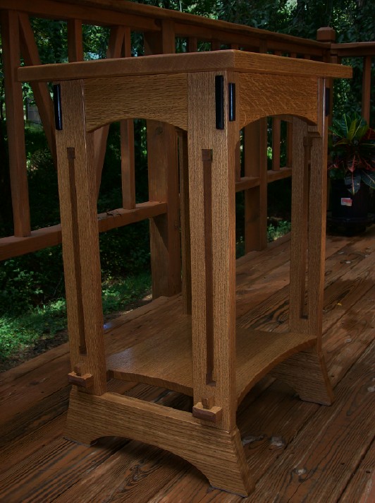

    She needed a table to accompany the desk-hutch and fish tank table I built for the study. No problems staying in the same style but... I had to accomdate an ackward printer on top.. a tall and narrow shredder underneath.. and she threw in her requirement for the bottom to be high enough for her female feline to hide and await in ambush. Women! And I wanted over-hang on all sides even though this will fit on a wall but.. I wanted the capability for the piece to be a free standing table in any situation when it is passed on in the future.
    There lies no problem so far but... it had to fit in a 25" gap between the computer desk-hutch and wall. Seeking balance and proportion under those constraints was the problem and a large one for a rookie designer as me. No Auto Cad to assist a given look after the mental solution was visualized. Just visualize.. put a plan on note-pad and cut hoping for the element of pure Pot Luck.
    The piece is QSWO with 90% darker heart-wood left over from 3 other recent projects. Gaboon ebony accents. All joinery was mortice and tenon.. bridles.. through tenons with no screws except for top fasteners. My design all the way so I have to take responsibility for however the results might be judged.
    Risk.. challenge can be very frustrating or very rewarding depending on the outcome. The piece meets the requirement for the electronics dimentions that will rest on it. But... does the outcome meet the design requirement of proportion and balance? You can judge for yourself.... and rest assured the pictures are horrible but what's new with me taking them.

    Nice,
    • gsmittle
      • 2793
      • St. Louis, MO, USA.
      Sarge, that's really nice work! I especially like the cutouts in the legs; it lightens up the legs nicely. Nice accents with the ebony, too.
      g.
      Smit
      "Be excellent to each other."
      Bill & Ted

          That is one neat table! I really like your design, Sarge.
            Very nice design and execution. And I'd say you have that marvelous finish perfected.

                  You really have an eye for proportion and a head for design. Another, "Wow-eee" project, Ed.

                    Hello Sarge,
                    That is truly a beautiful piece. I love the whole look. The legs, the joinery, and the ebony really set it off for me.
                      Very beautiful Sarge. Are the tenons ornamental or is it an actual wedged joint?
                        You should submit that to a good WW magazine! In spite of the odd construction requirements - printer, shredder, height, cat, it doesn't look the least bit awkward. Looks elegant in its proportions too!

                              This was somewhat of a simple build that took about a week and a half from rough stock to ready to final sand. Detailing such as accents.. cut-outs and curves.. throughs took 3 days of that as you can't get in a hurry with details. Doesn't take long to cook the turkey but if you spoil the trimmings the turkey just isn't as appetizing. Final sand was about 2 hours with grain raising but.. the finish adds another two weeks with application.. dry.. cure.. final rub-out.. wax and cure. So.. a month with some boring dead-time "tween".
