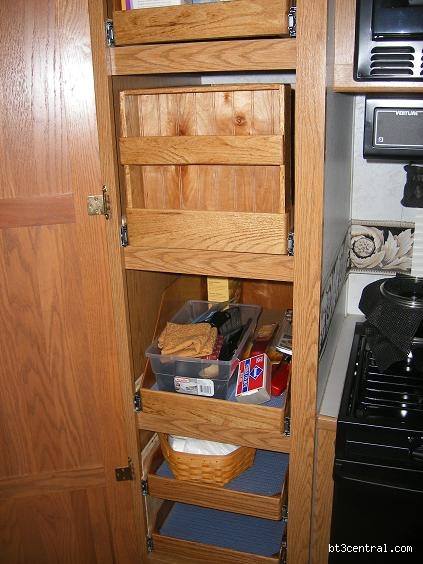

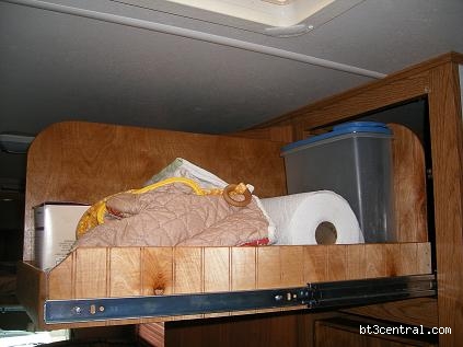

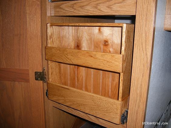

    Last fall I took measurements for those pesky pantry shelves that are about 14 inches square on the face and 24 inches deep. They were useless in getting anything in and out past the half way point. If you wanted to get something in the back you need to take everything in front out.. So My solution was to make drawers with full drawer extensions. The one at eye level has a spice rack on the front. another I divided in two for short cans and goods. When I brought the unit home from storage I got busy installing them.
    The door closes and holds all in place while going down the road.
    PS. The Level is useless when installing in a MH sitting on an angle!!

    Looks like familiar oak to me...nice work.
    Is that some kind if bead board I also see?

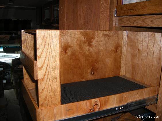

      Oak and scraps
      I had some pieces of bead board I used for the sides and added the oak fronts. mostly scraps I had here. The thin bead board was good in the fact that weight is a factor.
