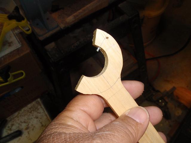

    One was a spanner wrench to fix a pesky door at work.
    I designed and made this spanner wrench.

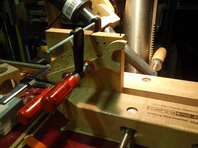

    At one point I had to drill a radial hole at a weird angle in an oddly shaped piece. Got out all my clamps for this one. How to kludge up a Clamp fixture for one time use.
    Used a piece of wormy hardwood i had - that explains the random holes, ha.

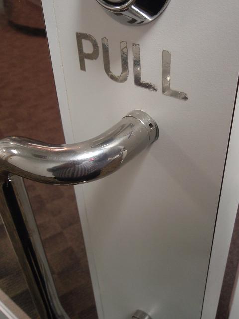

      Its the front door at work. The handles are simple chromed metal rods folded into U-loops on both sides. There's 2 threaded studs going through the door. On one side there's matching chromed nuts top an bottom that draw the two handles together on the studs. The nuts are smooth chromed round donuts same diameter as the handle rods, they rotate using a simple hole and a spanner wrench. The pin in the wrench ID fits the hole. and that's about the only way to tighten this up.
      So the story is, for three years now it drives me nuts that the handle is always loose. A couple of times I tighten it up by rotating the ring but there's no way to get any real leverage on it without a special spanner wrench.
      Its probably really the responsibility of building services (leased space) but its never tight and I mention it to the receptionist that some one should fix it and its never done or doesn't last. I finally decided last week I was going to make me a tool to fit. I'm thinking about sneaking some loc-tite in too.
      The real reason it comes loose is it's also got a bend in it, so pulling on it puts a side load on the base which causes it to work loose.

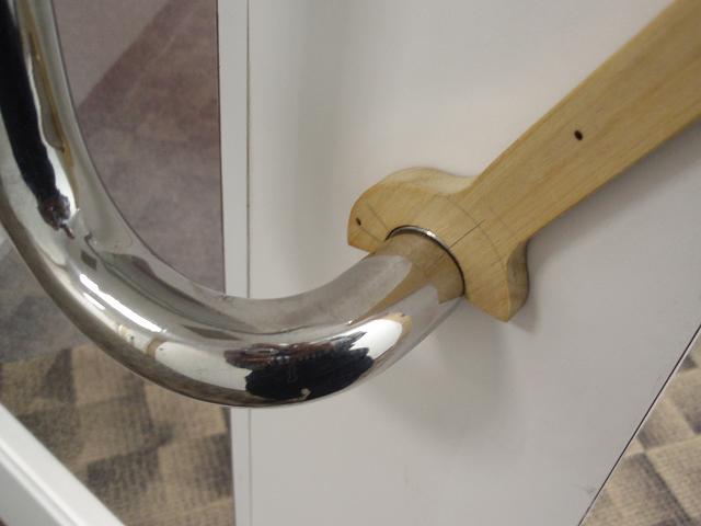

                      The door handle is pictured for those who wanted to see it.
                      At the base where it meets the door is the locking nut. I assume its connected to a rod that has right-hand threads one end and left-hand threads on the outside to pull the two handles together.
                      As you can see the wrench fit absolutely perfectly and I tightened the lock nut.

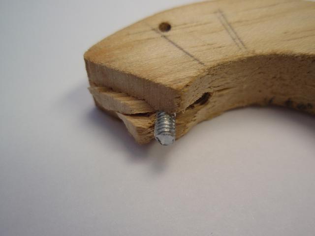

                      But as I really torqued down on it the pin blew out of the wood as you can see the in the third picture.
                      It split along the grain, there's a lot of force on the pin, a #2 screw, it even bent some.
                      Compare to the original position as shown.
                      I'm thinking I really need to make this out of Aluminum or steel.
                      But I'll make one more try... lengthen the nose so there's more wood in front of the pin. I'm going to cross drill the spanner where the pin goes thru and insert a 3/16" dowel so that the pin goes thru the side of the dowel, this will give it some cross grain to hang onto.
                      I'm going to install a #2 nut in the top and bottom (I'll have to recess it in the spanner) so that the machine screw is hanging onto steel threads rather than the wood threads. Probably hopeless. I can already visualize where the cross dowel goes it will be pretty thin, especially if I add the nuts, so the main curved piece will probably break there.
                      Any suggestions? Harder wood, maybe maple or brazilian cherry?

                        You could use stronger wood and make the outside diameter of the spanner end a lot bigger.
                        Aluminum would be the next choice.

                            I think the problem is you're going to have problems finding material that can handle the forces involved, short of aluminum or steel. Which makes this a different kind of project.
                            I'd take two 2" x 12" (or so) pieces of hardwood and clamp them together to make a 4" x 12" piece. Drill a handle hole (what is this, about 1"?) approx. 3" from one end of the clamped together pieces of wood. The hole should be centered on the joint between the two pieces of wood, so when you separate the pieces they each have half of the hole.
                            While the pieces are still clamped, drill two 1/4" holes through the edges of the pieces, on either side of the handle hole, to use to join the pieces around the handle.
                            Separate the pieces, add a hardened machine screw as your new pin, and clamp this thing around the door handle using 1/4" bolts and nuts.
                            If all else fails you can order a spanner for $10, too. But I do understand why you started this.
                              actually i did look for one, i could not find one with a 1" dia. an a .100" pin.
                              the other problem is that the ring is only 3/8" wide, the pin is 3/16th from the edge so there's not much support material, esp. if you want to be able to go on and off.
                              Probably the door handle mfg makes one to go with the door, but who knows where that is.
