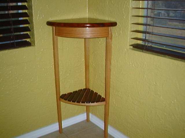

    The top and bottom slat shelf are padauk, and the legs and aprons are red oak. This was my first try at steam bending wood. It worked out pretty well, but boy was it a learning experience. I tapered the legs on a shop built taper jig and everything is finished off with 3 coats of danish oil and lots of lacquer. Thanks for looking.
    Well done, Exodus. You are a busy beaver here lately. The Paduak speaks for itself and you did a nice job of chosing straight grain red oak to go with it. Nice legs... kinda like some of those professional dancer girls have on Dancin' with the Stars. And don't tell my wife I said that.
    Keep up the good work...
      It looks like it paid off very well. That is one sharp looking piece of furniture.
        I think you posted that on the wrong forum, it should have gone in an "ART" forum! That is really a stylish piece, you should be very proud of it.

            That is a very nice piece, with a distinctive and contemporary look. One to be proud of...

                      Would you care to share some of your steam bending experiences and lessons with the rest of us?

                        Here is what I learned Poolhound:
                        -you have to be really fast once you get the piece out of the steaming rig, The wood does not stay flexible for too long
                        -have your clamps ready to go, and it also helps to have your form securely fastened to something solid.
                        -when you think you have cooked the wood long enough, cook it some more!
                          Did you use thin rips and laminate them back togeather? or just bend a thick piece? From what I've read oak isn't the best bending candidate.
                          I bent some 1x2 cedar for a garden trellis once, but I didn't steam it, I just soaked it for a week.

                            I bent one piece of 3/4 oak. It was about 3 times as long as I needed it. I tried with shorter pieces, but they broke. Too much stress I guess!
