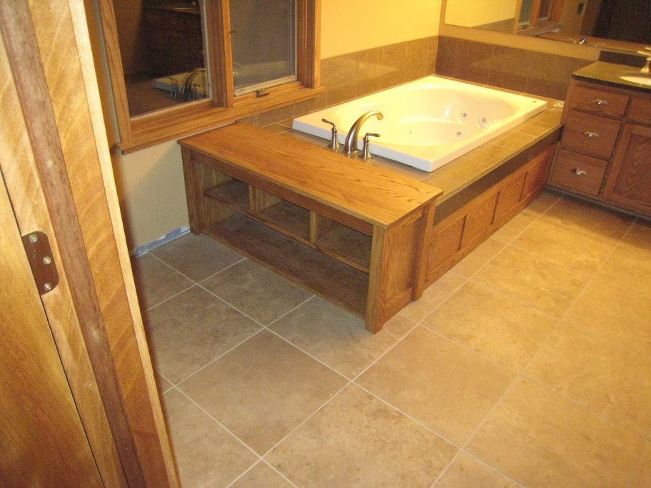

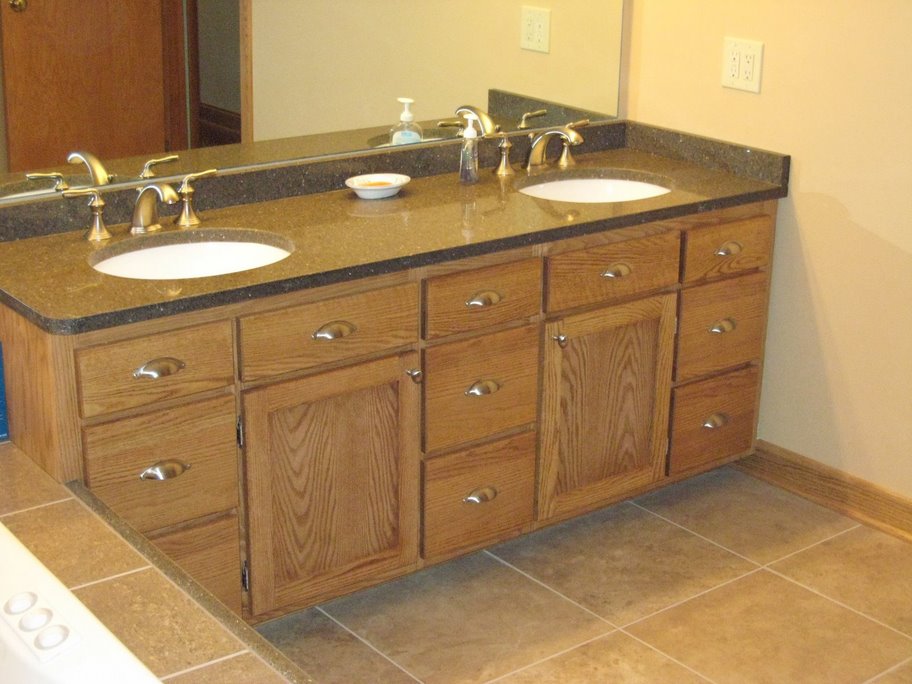

    After getting some outrageous quotes from some local cabinet makers, I went ahead and built these up last weekend.
    I took these pictures after the granite guy finished.

              I'd like to tell you a story about how it was a 10 step process... but in reality: two heavy coats of MinWax Golden Oak, 3 coats of MinWax poly. **yawn**

                  This was my first real "cabinet", and as such I really didn't know what I was doing.
                  I used pocket screws (and a glue) for most of the joints.
                  I built it in two pieces (so I could carry it myself).
                  The cabinets are the parts on the ends (stack of drawers and the door part). The middle section of drawers is just the space between the two cabinets. I built the face frame in one piece, and covered the whole thing.
                  I had to have a custom built vanity because (1) if I wanted to keep the ridiculously large mirror, it had to be shorter than a normal vanity, and (2) because we wanted drawers, the spots the pipes came out of the wall interfered with the typical drawer locations in stock cabinets.
                  The bench is just installed with 6 screws underneath. It covers the tub plumbing, so it will be easy to get to (heaven forbid).
                  We were going to top the bench with the same granite as the vanity top, but the stone was damaged during fabrication, so I had to glue up an oak panel. It turned out ok, but had I known, I would have made the bench 1/2" taller (so there would be no gap under the window).

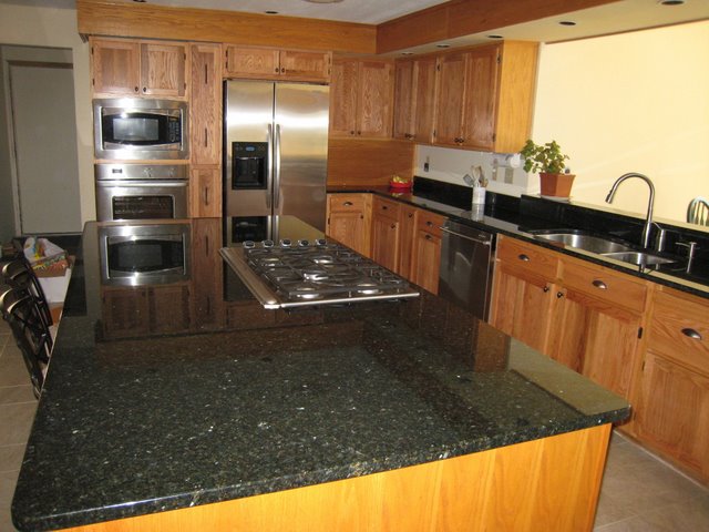

                          Oh, that was last summer:
                          http://picasaweb.google.com/seekins/...eat=directlink
                          Just new doors and drawer fronts, counter tops and appliances. The cabinets were already faced with nice oak, and are solid birch plywood. We couldn't think of any better way to lay out the kitchen anyway.
