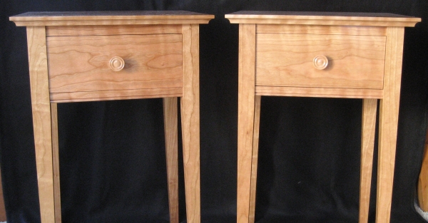

    Look at me -- I'm still woodworking! Not sure how long the streak will last, so I guess I'm trying to make the most of it....

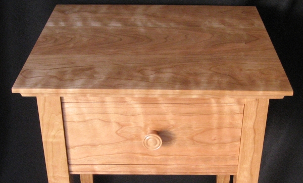

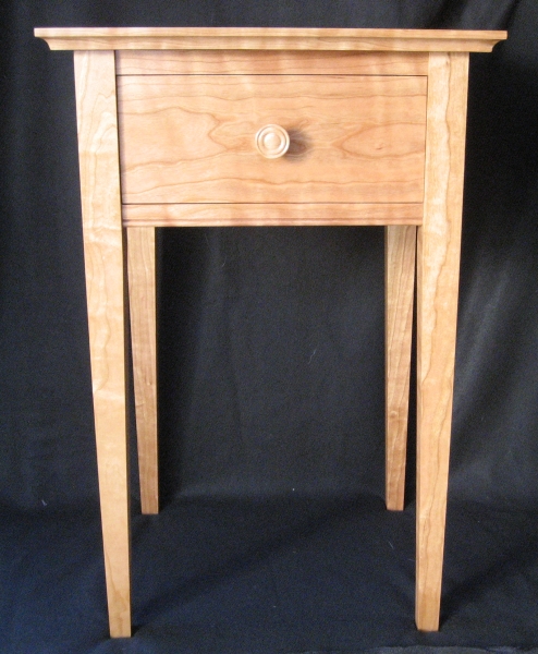

    Perhaps the wife was hinting to me when she put a lamp on a cardboard box next to the bed, so I got to work. Construction is all cherry (except for BB corner leg braces just under the top, and maple drawer sides and bottom). I turned the knobs from a matching piece of wood. I decided against gluing up 4/4 stock for the legs, which required a costly lumber run (costly because, in addition to the 8/4 cherry for the legs, I saw some 12/4 maple for another project...). The side-by-side picture gives an idea of the change in appearance with viewing angle, as the two really do match (I swear). The finish is BLO (after a sealer coat of 1# shellac), with shellac overcoat to seal in the BLO, then a few coats of wipe-on poly.

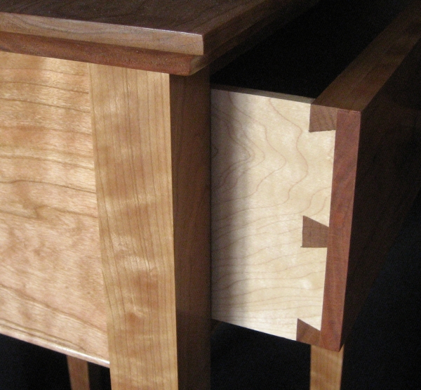

    This was my first attempt at handcut dovetails -- seemed like the right number of drawers to try it on. I've done some web-research on technique, and thought about it for a while, but there's nothing like actually doing it to decide what works and what doesn't (at least for me). I made through dovetails using a half-thickness of drawer front, and then glued on the front to complete. I cut tails first, and marked the pins, straight cuts with a dovetail saw, waste cut out with coping saw, and used a guide block and chisel to pare to the line.

    Nice job on the dovetails!
      Outstanding craftsmanship throughout. Treat yourself to a cold beverage. You deserve it!
        Great work Tom and lovely figure in that cherry. The question is, does the wide like them or prefer the cardboard box?

          They are be-you-tee-full! Nice work!

            Truly beautiful work, love the figured cherry, and outstanding work on the dovetails, I am envious of your skills.

                Wow, very nice. The dovetails look great!

                  I love the dovetails, the Cherry is awesome. Great Job, Bill
                    Those really look good! The dovetails are awesome!!
                      Very nice job on those, Tom. Glad to see you attempted and executed the DT's. They are really not very hard as the more you do... the easier it gets. I got a kick out of your wife's attack plan of putting the lamps on card-board boxes. She must be distantly related to my wife.

                        Wow....nicely done! The dovetails came out perfect. I like the quarter cove under the top. Very nice touch

                          Really nice work! And it will become even more beautiful with time.
                            Those turned out really nice! The dovetails are awesome.
