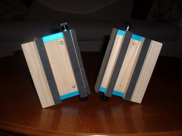

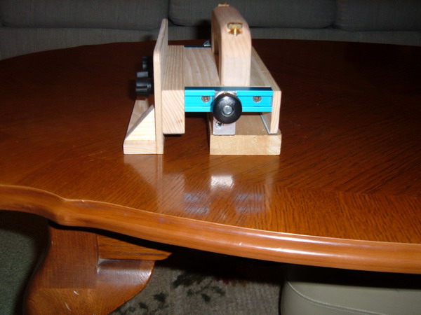

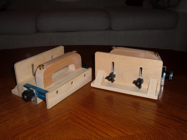

    I read that some people were their own grr-ripper push blocks so I decided to give it a try and this is what my efforts yielded.
    My wife's first concern was that I didn't make the body of it thick enough. She said "if something happens your blade would go through that 3/4 ash in nothing flat".
    I don't feel that is a concern but I could add some thickness. What do you guys think?
    Here are some pictures.

      I think you do some very nice work. I also think that the saw blade would go through the plastic body of a real grr-ripper more easily than your wooden ones. I would not worry about it.
        Those are pretty nice. Is that sandpaper on the bottom?
        I've got a pair of the plastic ones and I use them all the time. The only feature I saw that you didn't incorporate was the movable handles. I will reposition mine at times, especially when I don't use the foot portion.

          Awesome job. As far as protection, how about gluing a piece of aluminum on the bottom?

                  As far as going through the 3/4" ash, don't expose too much saw blade and you don't have to worry about it.

                      do you have dimensions that you could share?

                        This isn't my design. I copied a picture so be my guest to do the same.
                        The bottom of the legs is the rubber from a thin mouse pad. This stuff grabs like crazy.
                        If you look at the bottom view, one of them has two extra holes. That allows me to move the handle from side to side. However, I can't move it very much as I didn't allow enough room for my hand to clear the fense. (Perhaps a taller handle would make it better.)
                        Overall dim. is 7" long and 4" wide. Two legs are 3/4" wide and the narrow one is 1/4" wide.
                        The support leg is about 1 3/8" wide by 3 1/2 " tall. The handle is 6" long.
                        You might want to increase the length of the entire unit to accommodate a larger handle, depending on the size of your hand. My hands are pretty slim. Also, I'd suggest increasing the height of the whole thing so your hand doesn't run into the fense when the handle is positioned over the thin leg. (ripping very thin strips, 1/4" or less ) If I do another one, that's what I'll do.
                        The rest is pretty simple. T track from Rockler, knobs, bolts, etc.
