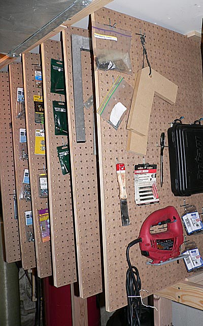

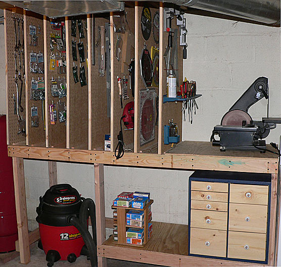

    I told you I'd post pics concerning blade/miscellaneous storage. I'm not quite finished, but I removed an old freezer, and built a storage solution. There are eight pieces of pegbaord, each about 24" X 40". Each one slides out for access.
    A shot from the front

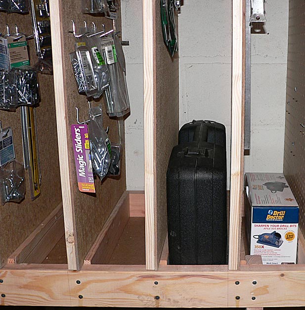

    This shows the stops to keep the pegboard from being pulled out too far
    Multiiple pegboard storage
    Blade storage

    Now that is an interesting use of peg board. Are you using both sides?
