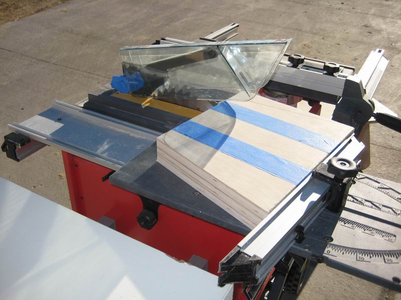

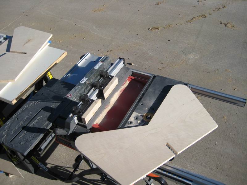

    I got to use all of the BT3 (Sears 21829) features on my first go around. Almost joined the club on the angle cuts. I LOVE having the integrated router table.

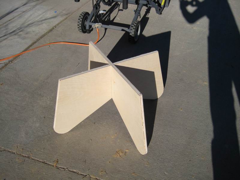

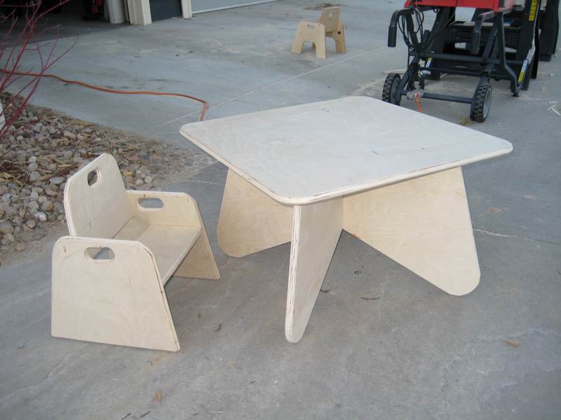

    My daughter's day care asked if I could build a table and chairs. I modeled the chair off an existing chair that they had (in the background on the first pic) and tried to match the angles/curves to the table.
    If only the Borg 3/4 Birch wasn't a 1/16 off in thickness, my slot/slip fit would have been perfect....or I guess I could have measured the thickness first.
    The top is joined to the legs via Kreg Jig screws.

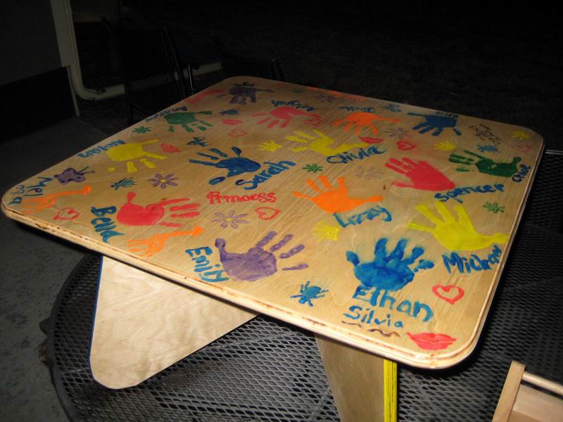

    I let the kids at her day care put their hand prints in paint on the top.

            I like that... Not sure about HD, but I am pretty sure that the Blue Box 3/4" is really 15/32", and a 32" Dado / slot would be a hair loose...
            Wood Magazine's current issue has a good write up on getting tight dadoes, you might want to check it out... That is unless you used a router bit for those slots, in which case you kind of stuck with the thickness they give you...

                    DB, yep. don't have dado yet. That's on my wish list. I used 3/4 router bit for the first slot. then after test fitting and finding my error; i used the stock blade and just nibbled the second slot.
                    Here's the finished product w/kids handprints:
