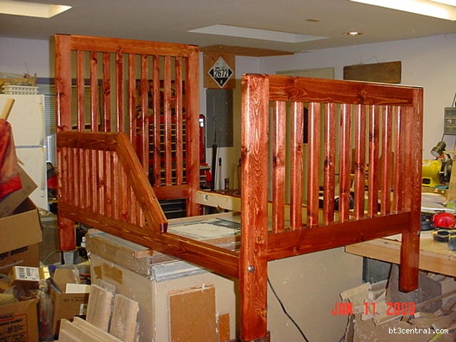

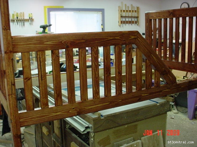

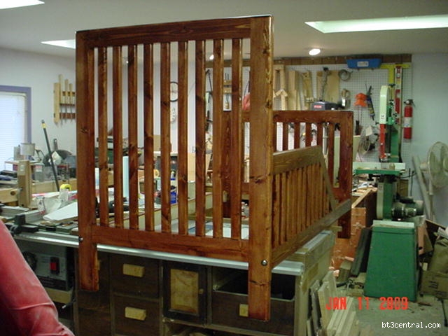

    My own design. 2"x6" pine T&G flooring was used for the whole thing. T&G ripped off then all parts cut from there. This is the project that convinced me that I needed a better way to cut mortises. Bed rails are located with two 3/8" dowels each end and attached with 3/8" slotted head machine screws flat washers and nuts. Finish is Minwax Red Oak stain applied after a pre-stain conditioner. Two coats of wipe on poly, followed by 3 coats of brush on gloss poly.
    The middle pic is closest to the true color; the other two the flash did not go off. I only put a raised rail on one side as the other side will always be along a wall. Once Thomas get so he does not need the rail to keep him from falling out of bed it will be a simple job just to make a new rail. The top rail is not attached to the head board but has two locating dowels just like the lower rails. The bottom will be 1/2" ply wood held by just a 1/2" x 1/2" rabbet. This is sized to use his crib mattress. I figure he will be in this for two to three years then he'll move into a bunk bed.

    As a big Three year old I am sure he is proud of his new bed!
    Very Very Cool
      Ah! Very cool design. I am sure he will enjoy his new bed.
        That is a nice design and very functional. I made a similar designed bed for use with the baby mattress for our youngest some years ago, but it was not mortised like that. Yours looks MUCH better than mine did.

          The bed turned out nice.
          It looks plenty sturdy enough for a rambunctious 3 year old.I am sure he will put it to the test.Mine always did.
            Nice work, Mark, and a good, sturdy design for a boy's bed.
              Very nice design, Mark, and I like the stain - I used the same for the furnishings in my boys' room.
                Nicely done, Mark! I hear you on the need for "a better way to cut mortises". That's one task that requires way too much patience to cut by hand.
