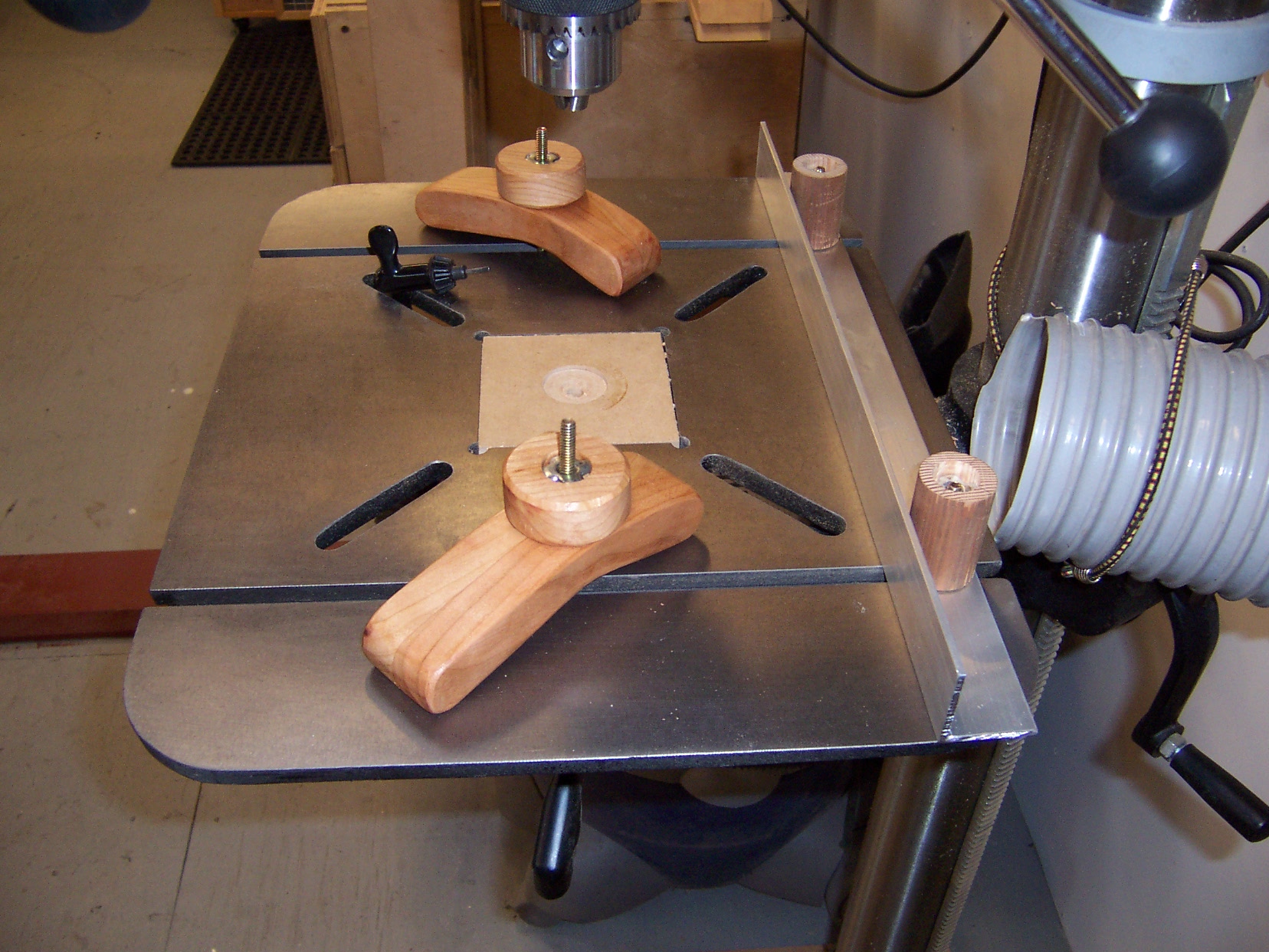

    Hold downs for drill press table and 1 1/2" x 1 1/2" aluminum fence.

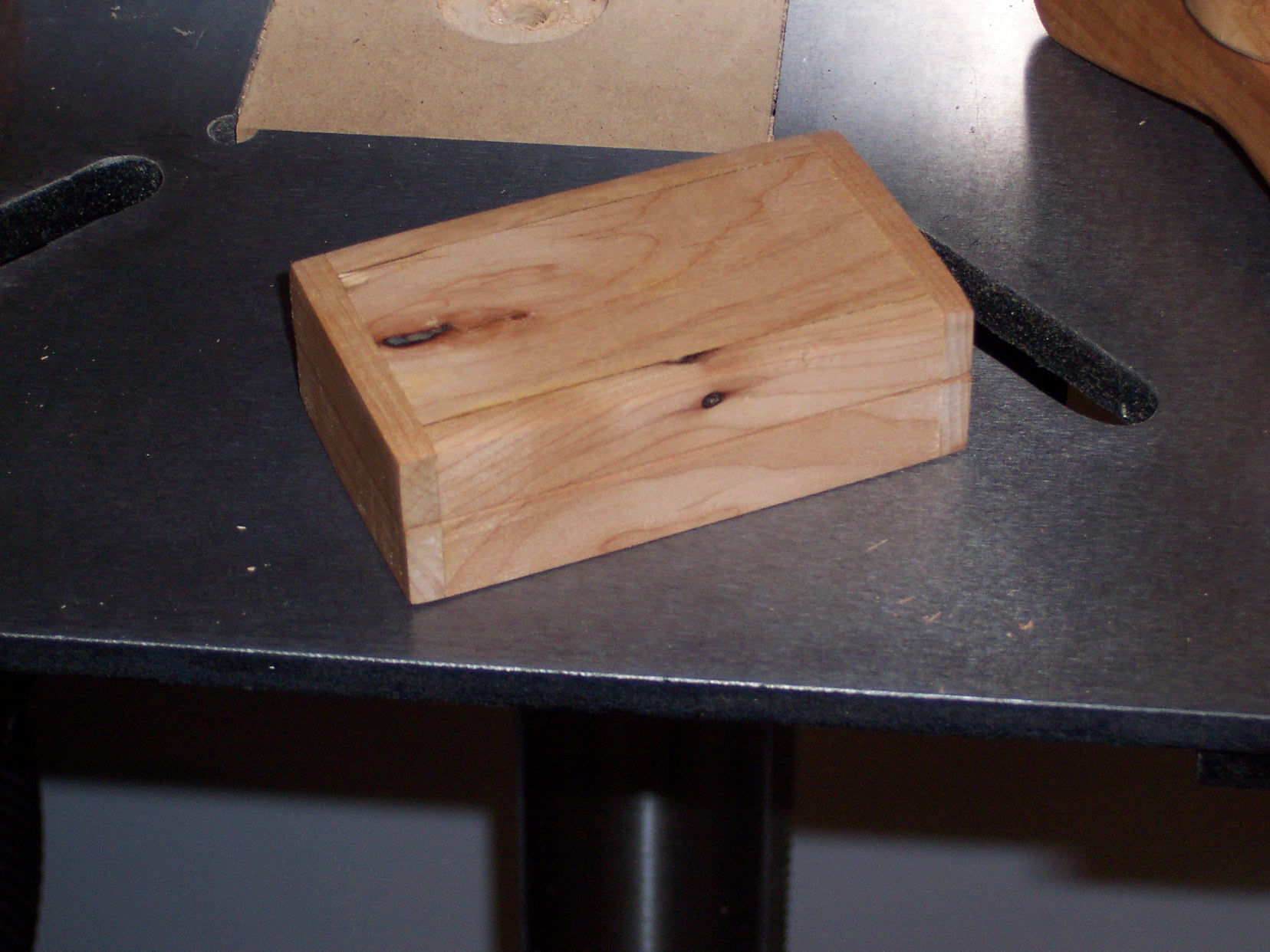

    Small box for gauge set.

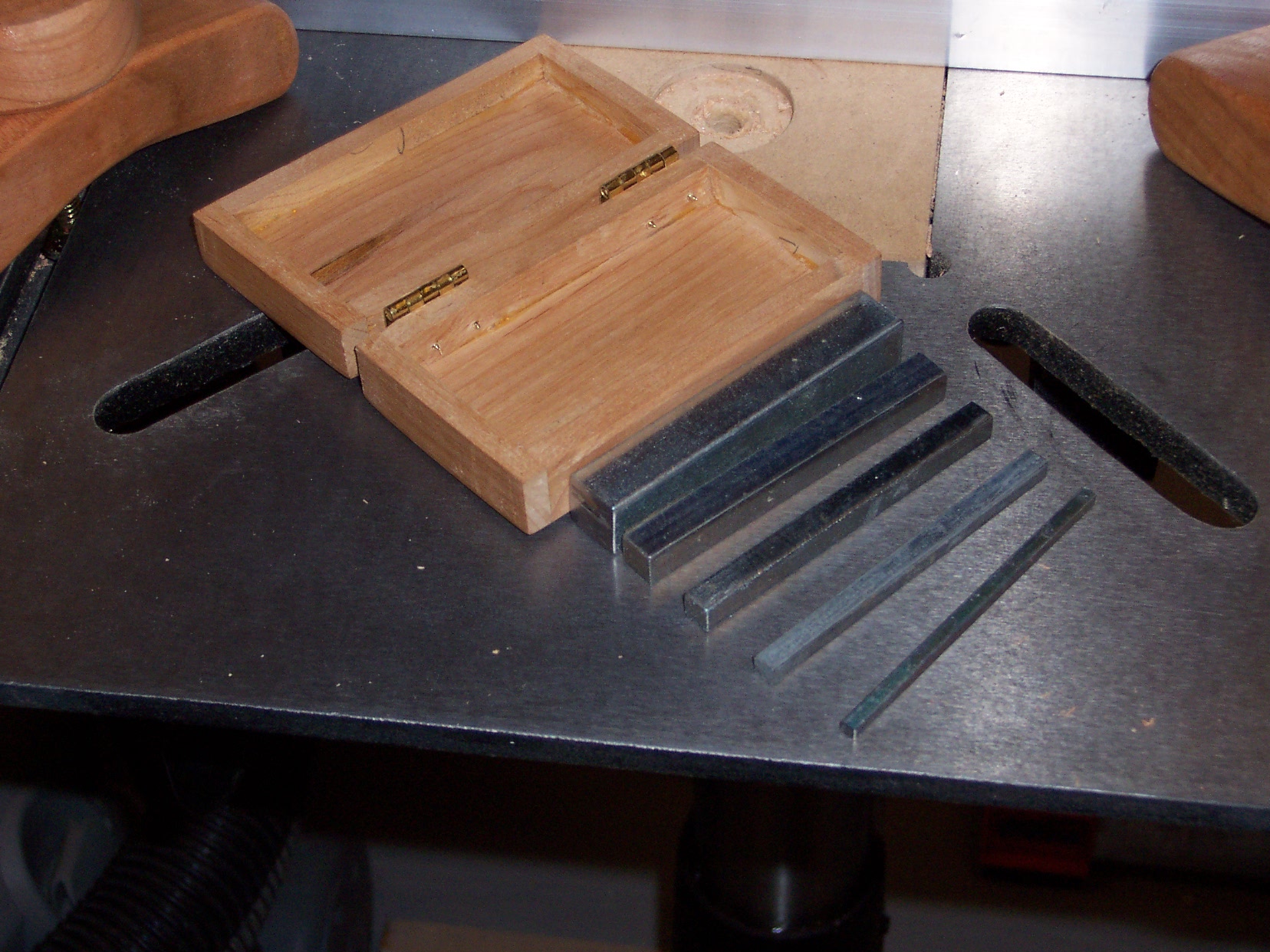

    Set-up gauges out of stainless bar stock.

      BTW. Larry, that is some nice work there. How did you make the knobs? T bolts are easy to come by and cheap. through knobs are a PITA to source locally, and shipping on web orders is fairly unattractive for just a fancy nut...
            The knobs are just pieces of the same stock(maple), two 3/4" boards glued together and cut out with a 1 1/2" circle hole saw, drilled then a T-nut for the toilet bolts. The knobs for the fence are cut from an old closet rod no longer used. I use to make these knurled, but found that they are plenty easy to grip just left round.

                • 9564
                Gotcha... Looks easy enough...
                I hope you don't mind a copycat... I bet you could plane down some clear 2x4 SYP to 1", and get a similar effect...
                Now the question is, am I gonna get sued for discussing this on a woodworking forum?

                    Originally posted by Larryl
                    ...drilled then a T-nut for the toilet bolts.
                    So you are telling me your T bolts are toilet flange bolts? How well does that work? The one thing that drives me crazy about T track is there seems to be a mess of different bolt sizes etc... for it. They REALLY should standardize the stuff...
