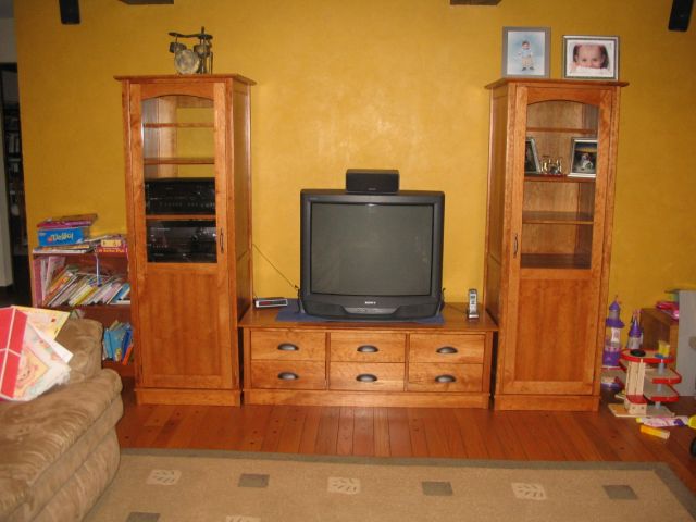

    Cherry Entertainment Center

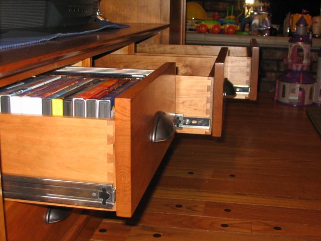

    This is my first finished project posting, so please be gentle. It's based on a Wood magazine project, modified to my wife's "suggestions." Made from cherry and cherry ply. Drawers were dovetailed using the Rockler jig--which I found more than adequate for my needs. Overall, it took me probably a year to build, but that's with maybe an hour or two of shop time per week, give or take. Finish is BLO followed by 4 coats of Arm R Seal.
    -Bryan

    Beautiful job! I am sure your wife is one happy spouse now!
    I had my eye on that plan from Wood for a long time; always wondered how it would turn out - yours seems to be perfect!
    Actually, yours looks even better ! (the pic from wood below). You increased the center drawers to six, nice.

              Thanks for the kind words. The modifications to the original Wood project were indeed made with an eye toward the large flat screen we plan on getting--probably this holiday season. The extra storage that comes as a byproduct is a bonus. I almost screwed up on calculating the drawer sizes. I wanted them tall enough to store DVDs in their boxes. When I calculated the original dimensions, I forgot to account for the fact that the drawer bottoms would be 1/4" up from the bottom of the drawers. Luckily, I had allowed just enough extra height that the 1/4" miscalculation didn't cause any problems a little planing of the bottom edges of the sides/front/back couldn't solve.
