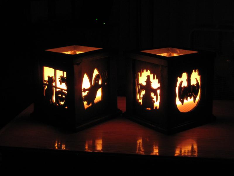

    This is more of an "arts and crafts" thing than woodworking, but this might be a fun activity to do with your kids...
    After discovering that the desert air destroys pumpkins in 2 days, I decided to try making something a little more resistant to the dry air and came up with these Halloween luminaries.
    Basically I stack cut some pumpkin carving patterns on the scroll saw, routed slots on two sides of a post, and slid the cutouts in into the post. The light is difused with a sheet of plastic light covering (the kind they put over flourescent lights at the office) that was cut and glued behind the cutouts.
    It seems like cutting patterns on the scroll saw is 1000 times easier than using those silly little pumpkin carving tools!
    thanks for looking,
    --tlt

        Those look great. How long does it take to cut something like that on a scroll saw?

                    Thanks to all for the kind words.
                    Thanks to the stack cutting, it was about an hour for the four patterns. One of the few projects I actually finished in an afternoon.

                      Very cool. What did you use for a light? Pat
                            It's one of those low, wide-mouth glass jar candles from walmart with three wicks. It would be cool (and safer) to work in some solar lights, if they put out enough light.

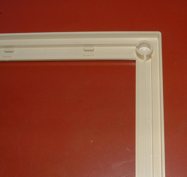

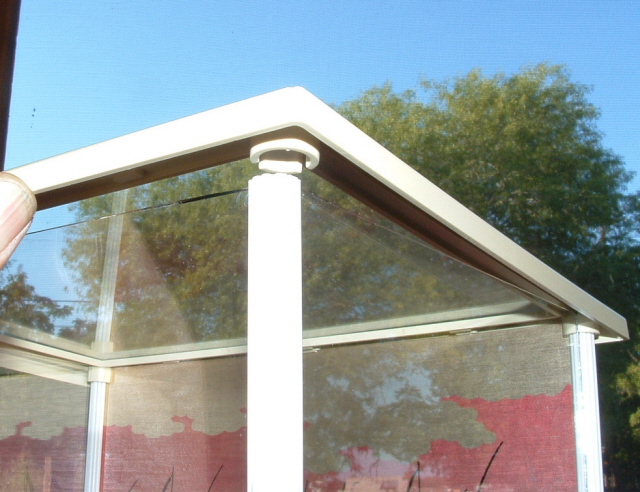

                            Originally posted by Pappy
                            Make the top piece a little larger than the 'box' with mortises to hold the tops of the posts. I have some display cases made this way, both plastic and wood. The top and base pieces also have a groove to capture and support the side panels. If this isn't clear, I will try to get some pics up later today.
                            I think I follow you, but wouldn't mind a pic or two The mortise on the top part makes it like an end cap, with maybe a hidden (unglued) dowel pin to keep it aligned?
                              Sorry about the delay getting the pics up. This is one of the plastic cases with round corner posts. Same idea would work with mortise and tenons.
                              The glass fits in grooves in the posts and the notches in the 'mortises'. On the one wooden doll case we have, the mortises are connected on 3 sides with a groove to hold the glass.
