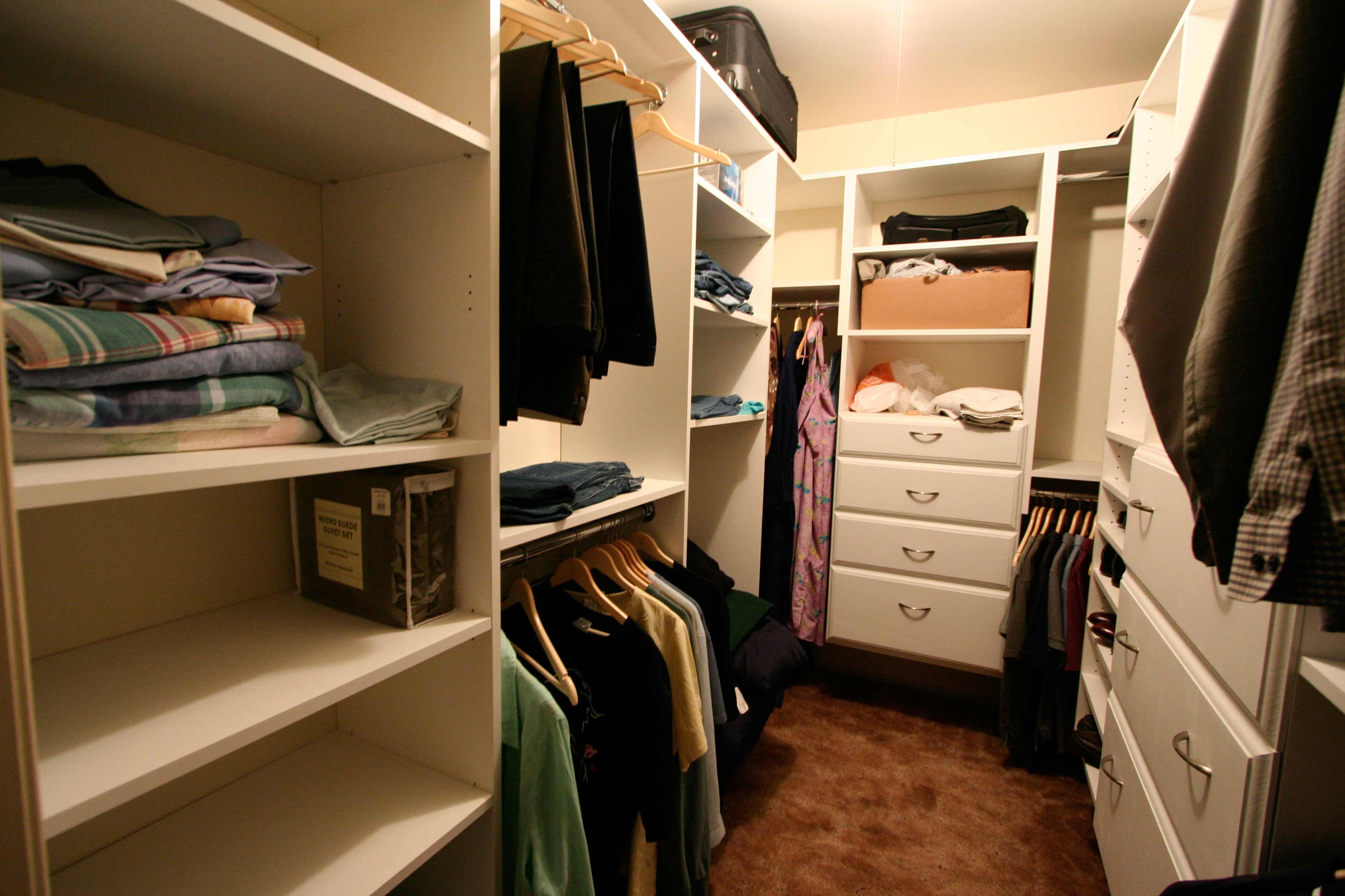

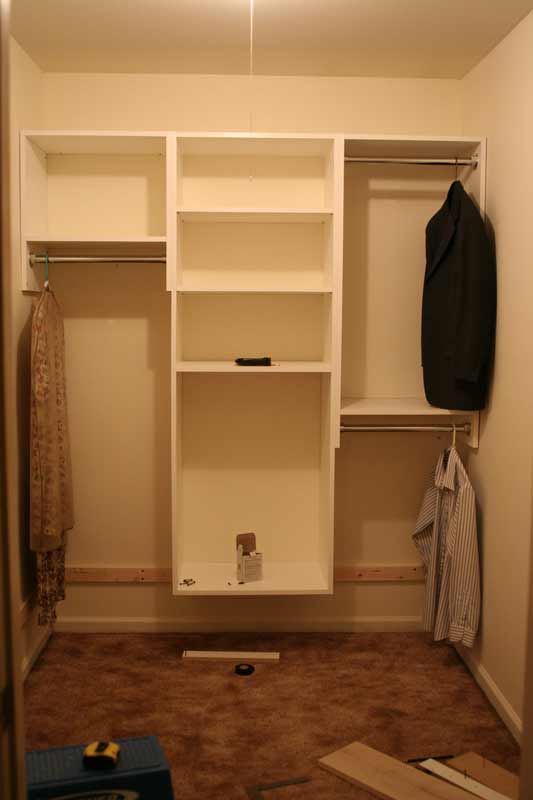

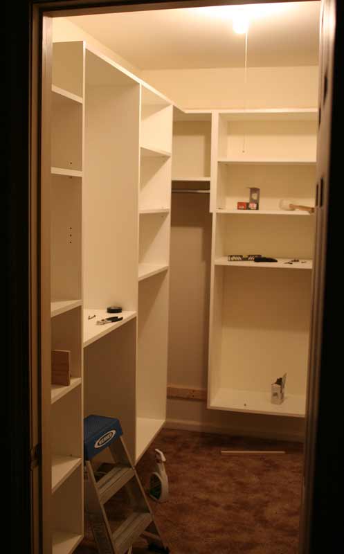

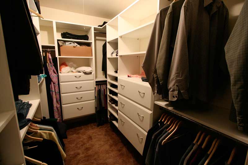

    This is a project I worked on a couple of years ago. I've been away from this site for awhile (I rotate through different hobbies), but I was recently reminded of this project and thought I'd post. Especially since most of what I know about woodworking I learned here.

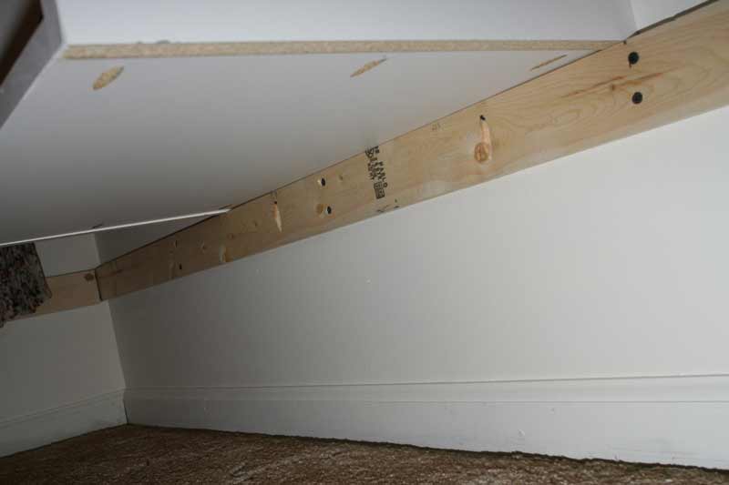

    I used Melamine purchased from Home Depot and made all cuts with a circular saw. All joinery was done using pocket holes. The separately assembled units are mounted to the wall by resting them on cleats that run the length of the walls 12" above the floor. This provides additional storage space underneath (and allowed me to leave the carpet in). The units are supported at the top by a cleat and pocket hole screws are also used underneath the fixed shelves that meet up with studs in the wall.
    The drawer insides are made of 1/2" Baltic Birch and are joined using pocket holes. The faces are poplar with routed edges and finished with a paint that I had them mix to match the color of the melamine.
    I was really happy with the overall cost and how this turned out using the standard size Melamine products from Home Depot. I also learned to have a great appreciation for pocket hole joinery.

    The only difficulty you seem to have had was in photographing it ! You have made the best use of available space.
    Very neat, and professional looking! Getting the paint mixed to match was a good idea. I should remember that.
    Great job!
    - Aristotle
      Great work and a timely posting. A remake of the wif's closet is in the soon to be offings. These pics should give her more ideas than I want to think about!

          Thanks. It was really tough getting pictures to do it justice in that tight area. The wider angle lens includes more in the picture but starts to distort it...
          I started out using a white paint that I had on hand and the drawer face just stood out too much. I brought a piece of the melamine to the store and it worked out well.

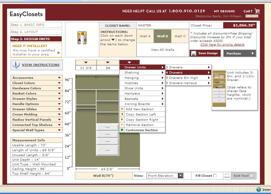

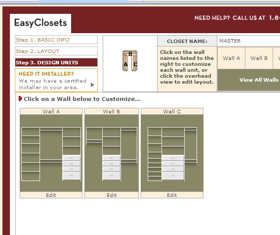

            If you're planning to do some design I really recommend going to EasyClosets.com. I have no affiliation with them but I'm willing to risk sounding like I'm pushing them because I can't say enough about how much their design tools helped me out. They were really easy to use. I feel guilty not buying anything from them after all the use I got out of them. I just went back to their site today and found that my design was still saved there after 2 years!
            I took a couple of screen prints (and used Photoshop) to give an idea of what's there. Picture #1 shows the left, middle and right walls that I wound up with. Picture #2 shows one of the walls and how you can build the units. You identify how wide each section of the wall unit is. You can then choose to have drawers, shelves, hangers and a bunch of other options. This really helped me for deciding what I wanted where.

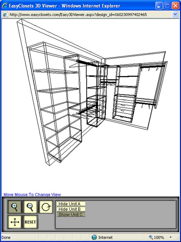

            Since this particular design was a walk-in closet (they have other configurations as well), the 3d view (picture #3) gave me an idea of how functional it would be. It allows you to walk inside and around and drop walls for better views.
            It's a lot better than building it and then hearing "can you move that unit over to the other wall? Take that shelf out and add a drawer. No, put it back..."

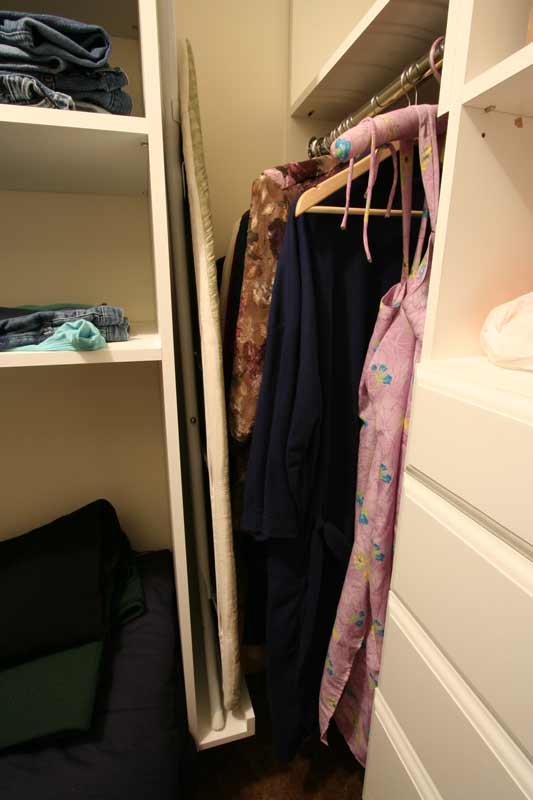

                            Thanks to everyone for the compliments. With regard to the use of all available space, that was a big goal of mine and I tried quite a few different combinations before I came up with this one. The pictures are misleading because they make it look like its a tight squeeze in there (for example the last one with the ironing board rest), but it really is pretty comfortable moving around and pulling clothes in/out out on the hangers.
                            Again, I have to give thanks back to this site because most of my skills I picked up from here. I plan to be visiting more often...
