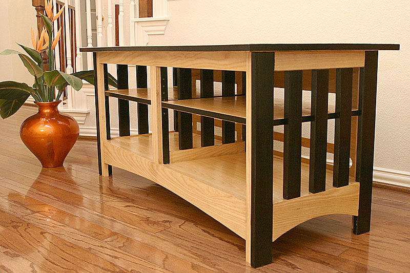

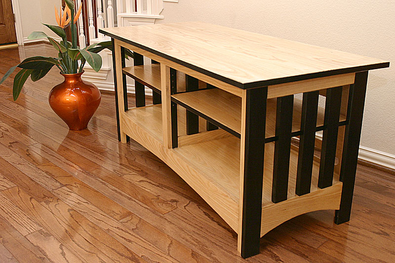

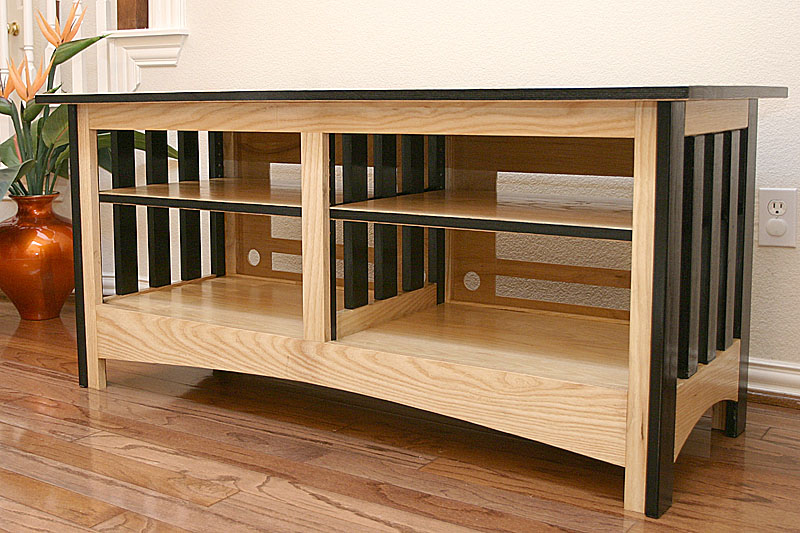

    Construction details:
    size: roughly 52"W x 23"D x 24"H. 2 adjustable shelves
    wood type: solid Ash
    finish: black parts "ebonized" with Speedball India Ink. 4 coats water-based polyurethane
    Construction time: 180,000s
    This is a modified version of a Woodsmith plan. Original plan is for a larger version with solid side and divider panels - without the "ebonizing." My amplifier gives off so much heat that I needed something open. Hence the slats.
    The Ash is very nice - whiter than what the pictures show. Artistically I was interested in a high-contrast result. Which is the reason for the ebonized Ash. The water-based polyurethane maintained the natural white color of the Ash.

    I like the contrast in colors. The ebonized wood pops out. Great job! Thank you for posting!

      beautiful piece of furniture! the contrast is great. i like the modified look (slats at the ends).

        Ash is one of my favorite woods for all the reasons that your pictures show. Good job on that one.
          That looks great. I'd have to run out and buy a new TV to do it justice!
            That's really sharp!
            How did you do the edge banding on the shelves? It looks like the ebony is inlayed into the edge in the photographs.
              Thats one really nice stand. BTW I love the floors did you do them?

                That is really classy. Beautiful work. Pat
                  Looks like it's all been said but I'll add my BEAUTIFUL
                    Very nice.
                      Good job! The ash looks great.
                        Very nice piece, Kofi!
                        • Knottscott
                          • 3815
                          • Rochester, NY.
                          • 2008 Shop Fox W1677
                          Very nice design and I love the ash. Great job!
                            That turned out very nice. The contrast in colors really makes this piece. Could you give some more details about the use of ink to ebonize?
                              The contrast and construction are stunningly beautiful! I really like that!
