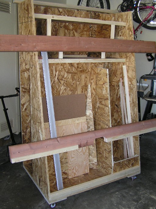

    After months of skirting a pile of cuttoffs and stock leaning against the wall, I decided I need to organize it, but don't have alot of room for any large storage in my garage-shop. Saw an appealing design in Shop Notes, #99, for a mobile lumber cart that also incorporate a sheet cutting "system" for those times when you need to cut down sheet stock.
    Instead of using the birch ply shown in the SN article, I took the economy route, and used OSB (consumes 3 sheets). Pretty much followed their plans for the rest, except minor design "improvements" here and there.

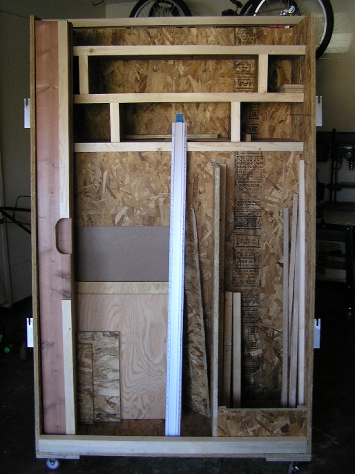

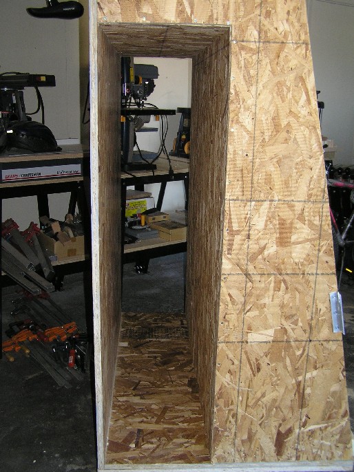

    This thing turned out a lot beefier than I expected - and larger. There's a small sheet storage area in the front (I added the lower bin area for long cutoffs), upper shelving, and a larger sheet bin area in the back; the rails for the sheet cutting "system" have a lag-screw near each end that hook onto the slotted aluminum rests fastened to the sides.
    Materials, all told, ran about $70. Assembled as shown in plans as butt joints with plenty of glue, but instead of screws, used my HF framing nailer - tricky, but worked OK.
    Thanks for looking.

        Thanks guys. Functional is key for me - is obviously not a thing of beauty that took alot of time and attention to detail!

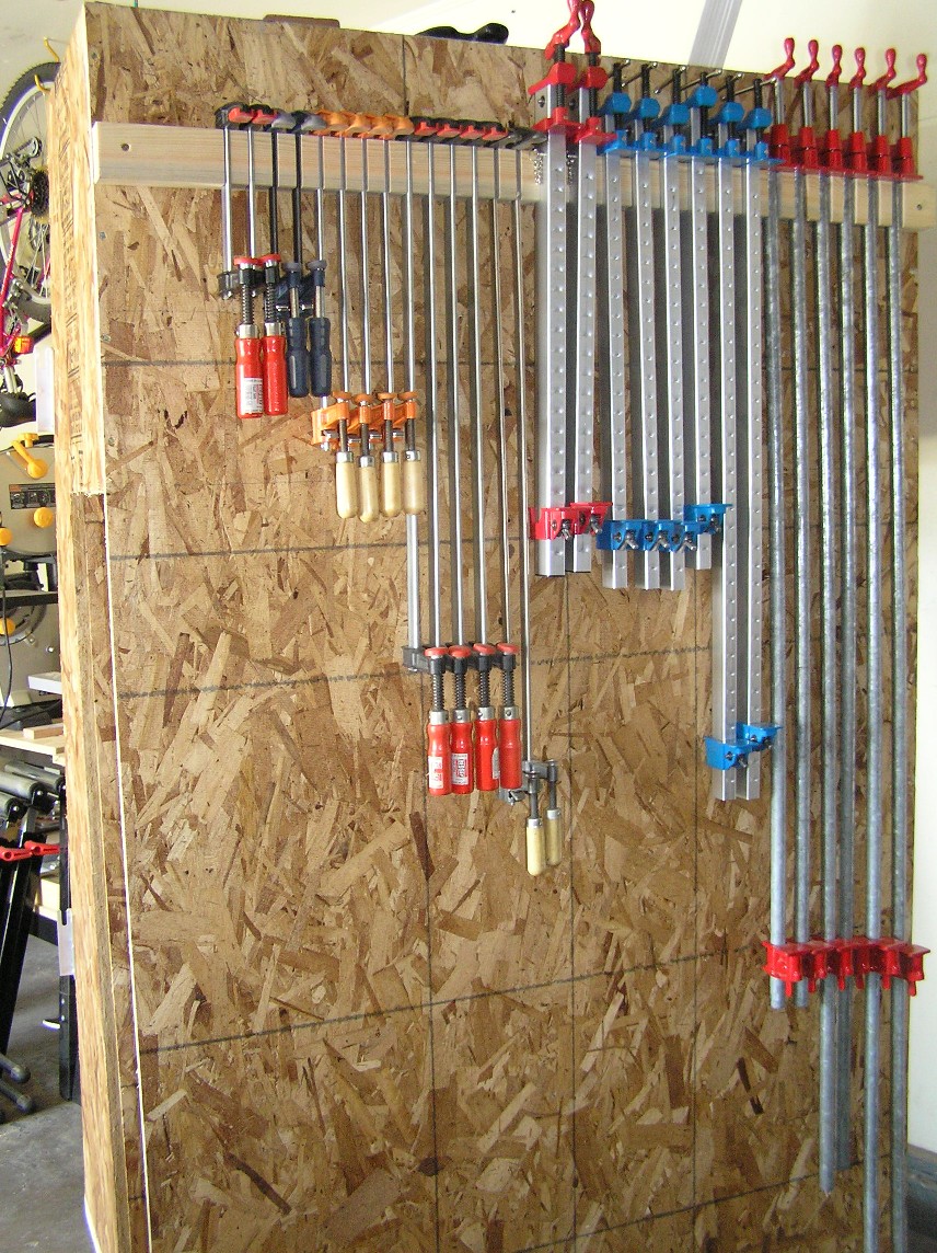

        I'm going to increase functionality by adding a clamp-rack to the back of it - all those clamps in the bottom left of this picture, and some not shown, need a home, and all that empty space on the back should work out well, I believe.

                Finally added the Clamp Rack
                I stayed with the "simple" concept of the overall cart. I just cut dadoes in a piece of 2x3 and mounted it to the back of the cart. Appears that it will work fine.
                Thanks for looking.

                  cool idea. good use of space. doesnt take any extra space.
