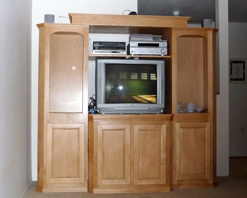

    This started as a picture of a similar entertainment center my wife found online. With some planning, a lot of trial and error, a substantial investment in the pocketbooks of the local hardwood supplier and just over 18 months this is what she gets.
    I made the doors, moldings. Face frames and carcasses are all assembled with pocket screws as I couldn't get clamps to fit the 45' angle or masking tape to hold the pieces tight enough.
    The finish is a water based Minwax, poly-crylic in an effort to prevent yellowing, we colored the finish with just a few teaspoons per quart of water based stain. I learned how to spray a finish and in the end it came out great.
    The only remaining item to buy is to buy the glass shelves that will fit into the sides.
    Lets just hope that we can always find a TV to fit this piece of furniture.

    Looks great! I made a little 45 pocket screw jig, they work really well for it.
    I used to use polycrylic, but found target coatings USL, and I'll never go back. I probably seem like a salesman for these guys by now, but if you are spraying a water based finish, I don't see how you could do better than USL. The biggies for me is no sanding between coats required, and just the finish was great off the gun.

      Very nice.

        Wow. Top-notch. Great work!

            Very nice.

              beautiful. Just enough stain to give the wood a nice rich tone.
                Good looking project.

                  That's a beautiful piece of work!
                    Excellent work. That is a project to be proud of.

                      Really beautiful, all your hard work and time really paid off.

                        Extremely nice work. Are you taking orders? Pat
                          That looks great! Where in the Tri-cities did you find lumber?

                            Looks great!!!

                              Nice! Beautiful design, beutifully executed.
