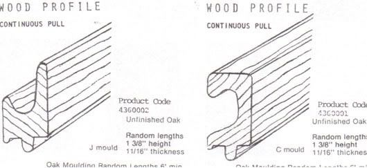

                I also like the drawer pulls -- what did you use to make them?
                  Thanks for the compliment. The drawer fronts can be done in solid wood and a "finger pull" router bit can be used for the "integrated detail":
                  Or, to have some continuity of grain for the drawer fronts, plywood can be used and an add on profile (available in random lengths, mostly in Red Oak) used on the top or bottom edge. To use these, the lip in the front and the spline can be cut off. The profile can then be glued directly and be "flush" to the front.
                  I've had many PM's for details, and I will assemble a tutorial for this project in the "Project Related Discussions" when completed.
                  Edit: I forgot to address the drawer construction. The drawers are done with rabbeted sides to accept the fronts and backs. The sides and front are grooved to accept the bottom. The back is cut short to accept a 1/4" hardwood plywood bottom. The drawer front is a separate piece.
