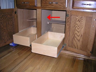

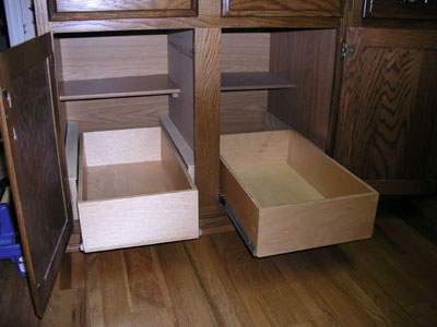

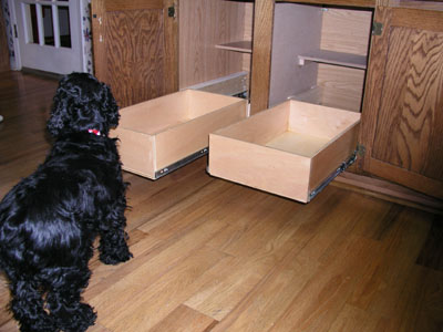

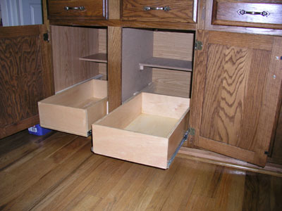

    This was a practical cabinet modification project that I saw in Family Handyman (or one of those magazines). We use our bottom kitchen cabinets for storing pots, large cooking pans, etc. It was always hard on the back and knees to get anything out of the cabinets.
    I followed the drawings in the magazine article and made one set (2 drawers) of drawer boxes mounted with full extension slides. We liked the results so much, I made two more sets. Then I made 4 more for a friend who wanted them for her kitchen. It makes retrieving kitchen items a lot easier.
    One day I might stain drawers to match the cabinets
    See pictures.

    They look very good, but You need to buy some food, or put the pans back in. Seriously, it looks like You have a space to move the drawers away from the sides, is it a 2X? Bill

      Did you add the plywood divider between the drawers? If so, how did you attach it?

          Lonnnie: Yes, I did. I made the dividers out of MDF and fastened them with 4 small angle pieces - two in front, two in back.
          I got smarter as the job progressed (isn't that usually the way ), and determined that I did not need such tall pieces of MDF as dividers. In the two subsequent cabinets, I used shorter pieces of MDF that went under the existing shelf. This way I did not have to reconfigure the shelf supports
          Bill: I actually mounted the slide units on 1 x 4s. If I had used 2 x, I would have lost drawer width. I put thin 1/4" 'caps' over the 1 x 4s, that's why they might look wider than they really are.

            As I was posting I saw and knew it wasn't a 2X. Bill
