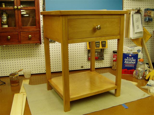

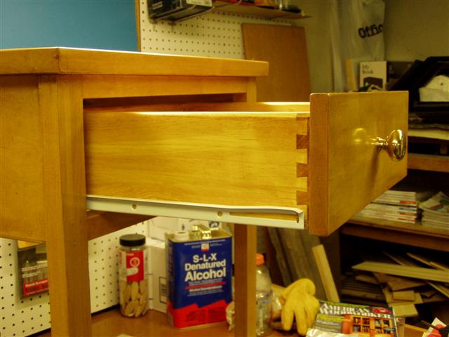

    This is one of 2 night tables I just finished.
    I used hard maple for the tabletop, legs an drawer front, and birch ply for the sides and bottom shelf, for the drawer I used pine.
    Sanded to 220, Sealcoat, 2 coats of minwax Cherrywood gel stain and 4 coats of wipe on poly.
    It had a lot of fun making this, This Is my first project using hardwood , I got to use many of my tools and I got some excuses to buy some more
    I learned a lot with this project, Man! Maple is hard to stain!

      Very sharp. Stain seems to blend the ply and solid wood well. Pat

          Your first project with hardwood and you're already into dovetails? Outstanding!

              You did a masterful job getting a consistent reveal around the inset drawer.

                  Good job! The stain work came out great.

                      Looks great! Great job on the dovetails and on the finish. Thanks for sharing.

                        Very nice. Those dovetails really look sharp.

                          Very nice. Totally my style -- simple look but a well made piece of furniture. Thanks for sharing with us.
