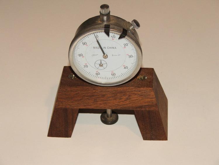

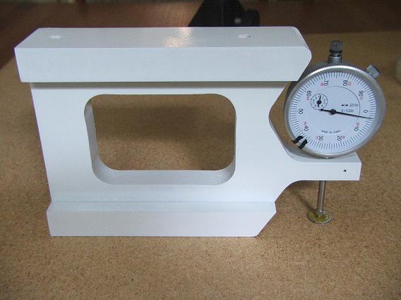

    I like to play around with measuring instruments.

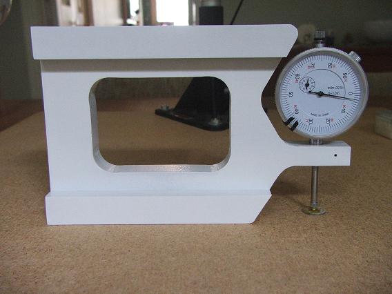

    You may have seen my previous height gauges - I've made three before, I copied the Oneway, inc "Multigauge" this time, just for fun.
    The Oneway Multigauge has some interesting characteristics, the cast and machined metal frame has three sides machined flat and you can make measurements up, down, and to the side.

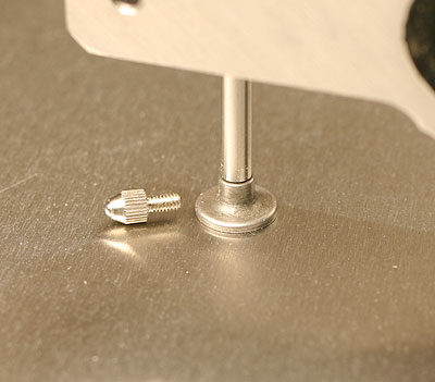

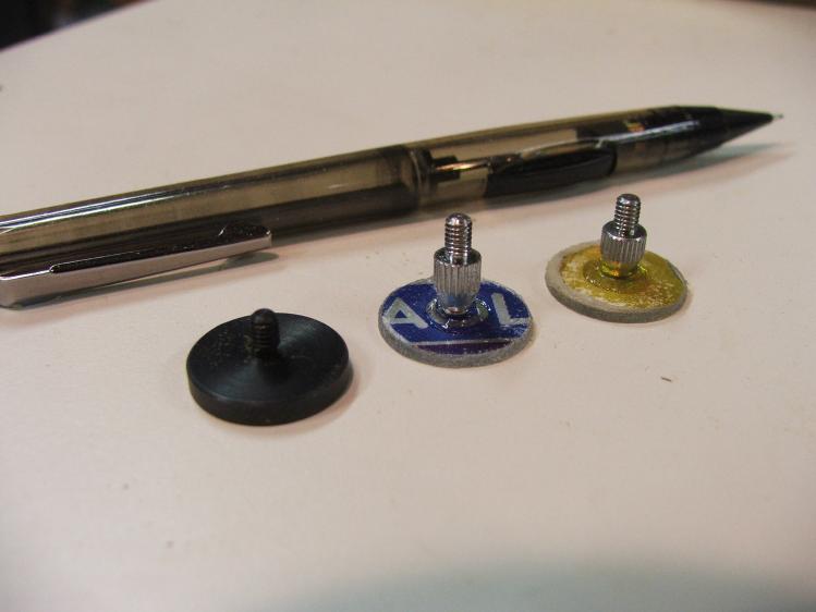

    I made the white frame of MDF to copy the idea. You can put a clamp through the hole in the middle to fasten it to any machine surface, I think I got the idea pretty well and the sides are flat and square. I long ago learned to make flat contacts and have posted that here before - they're necessary for measuring the highest cutting point of a bit or blade.

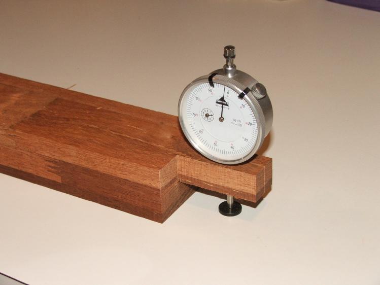

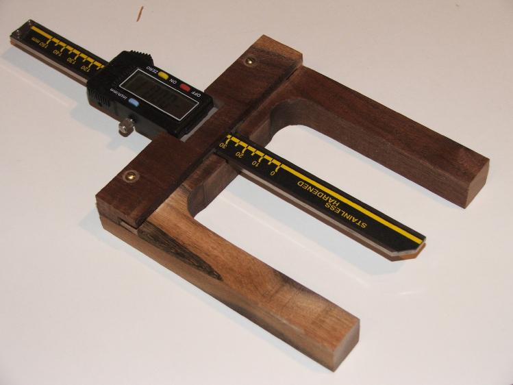

    Also shown are my previous devices - the "bridge", the jointer height jig and a tall height gauge using a caliper movement for up to 4" high measurements.
    These can all be used for height gauges but some have advantages over others. The dial gauge ones are spring loaded and can be set over a bit or blade and the hieght adjusted with two hands and none on the gauge. I like the bridge one for measuring router bit height. The tall one for adjusting over 1", the jointer one for measuring to the side of a long flat outfeed bed for pointer blade adjustment (works quite well), and the new Multiguage knockoff for measuring is diffferent planes as well as for routers as table saws.
    I also have the new HF digital dial gauge which can be placed in any one of my creations.
    (note: the First three images I think they show as "attached images" are of the oneway gauge. The next 6 images shown in "attached thumbnails" are my designs.)

    Very nice. Like the use of it on table saw blade height. Much better than a ruler when you absolutly must have the correct depth on a small dado cut.

                          The only thing I think I would have done differently is to make the unit thicker - As it is, if I lay it on its side then the lug on the back of the dial gauge hits the table first. That prevents me from laying it on its side and clamping to a table to measure, like Drill press runout.
                          But, the Multigauge does not allow that, either.
                          Hate to cut lug off - I'm concerned about what the vibration from cutting would do the the mechanical movement mechanism, which is probably akin to a clock movement.

                              Pretty neat Loring. I really like the multigauge idea. That one would do everything I need. So it's heavy enough made of MDF?
