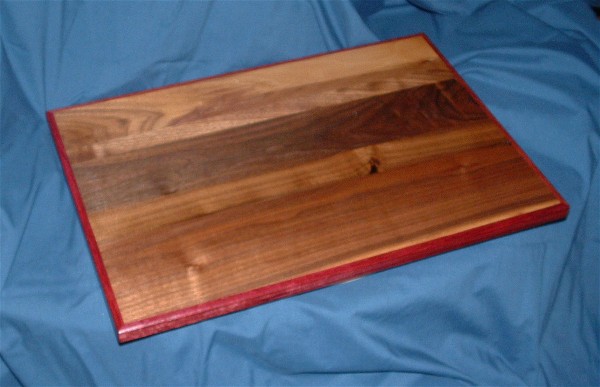

    The first is a turntable for the LOML to decorate cakes up to half sheet size. Walnut trimmed in Purpleheart with a plate glued to the underside and a base of 1/2 Baltic Birch. The underside is laquered and top is finished with 3 coats of salad bowl finish. She has already said it will serve as a lazy susan when she doesn't need it for cakes.

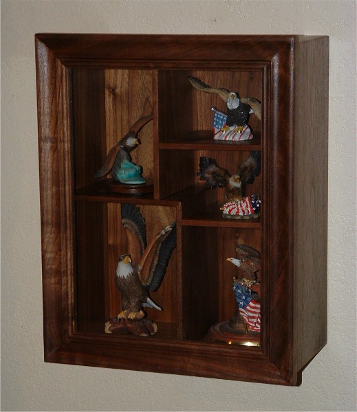

    The other is a wall mounted display case for some of my youngest's eagle collection. All Walnut stock except the plywood back using mortise and tenon joinery for the case and stopped dados for the shelves. Finished with 4coats of clear laquer.

      Beautiful Don. Excellent joinery.

            Great work! I like the display case especially.

                  Nice, Don! Sweet little display case...

                            Thanks for the warm fuzzies, gents! Fun projects, both design as you go. Closest thing to plans were some sketches for the shelf spacing on a dry-erase board.
