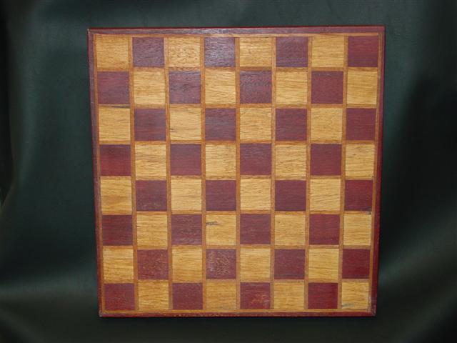

    well the quality isn't the best but I was proud of it for the level of experience I have.

    Chess board.
    Bravo! Those things can be tricky and it looks like you did a great job! I can't imagine cutting veggies on it. Definately a chess board.

      That is a really nice piece of work. Just keeping everything straight during glue up is a real hair-pulling experience.

        I agree. Chess board. That really does look good. I wouldn't ruin it by using it as a cutting board.
        Do you have any photos from during the creation of it ? I'd love to see how that went together.

          Thanks for the comments,no assembly pics sorry, I used purple heart,oak, and mahogony all scraps from railroad tonnnage. I did what most do I think? glue up the strips and spacers in alternating colors and then cut across then flip flop the pieces to create the chess board effect. I planed it down before I did the cross cut, that helped with the second glue up. The picture does't show it but the border really is bad, uneven sides and poor corners.

            if it was 7x7 I would say cutting board but you did count right (8x8) and it looks nice, so, chess board.
              That looks great. I'll say it's a cutting board. But don't cut anything on it. Use it for chess.
                Very nice looking work.
                  I'm amazed that you found Purpleheart in tonnage. Nice work on the chess board!
                    I think you did a great job. Too nice for a cutting board, so chess it is.

                      I've only found the one piece of purple hearty so far, lots of walnut,mahogony,oak and cedar
                        Looks good!

                          Nice work,
                          Tim

                            Good job. Definately a chess board.
                            Besides if I hear oak is to porous a wood for use as a cutting board.
