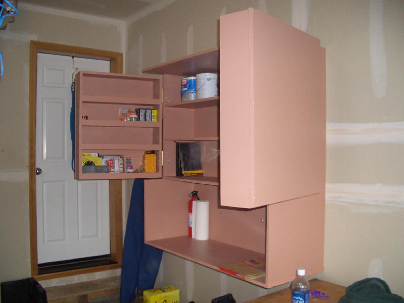

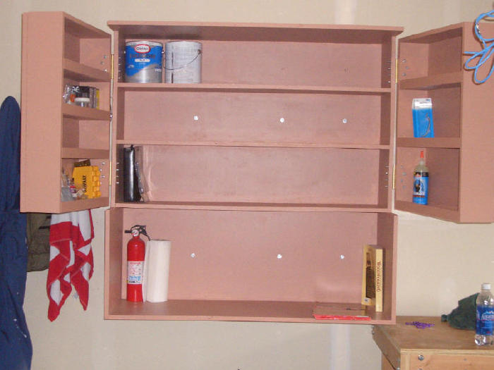

    Not going to win any contests, but it's functional and is providing more space and organization in the garage.
    A problem I had was making the doors square. The door backs are square, and the rest of the door pieces are measured and cut correctly, but I couldn't get them square while gluing the parts together. I used an assortment of clamps. I checked out Jeff's clamp tutorial, and it looks like the miter clamp might be helpful....also looked at the variety of clamps on Woodpecker.
    Harbor Freight has some less expensive clamps that look like they might work, but even those are $10 each (not on sale). Anyone use any of these? Or have other techniques to get things square? No doubt projects will turn out much nicer once I figure this out.

          Thanks everyone,
          The cabinet looks pretty good in the picture....the problem with the doors not being square is not much of an issue for this particular project. When I move on to furniture for the house, I will hopefully have refined the skills a little.
          You can't really see in the pix, but the edges of the door backs aren't square with the door frames.
