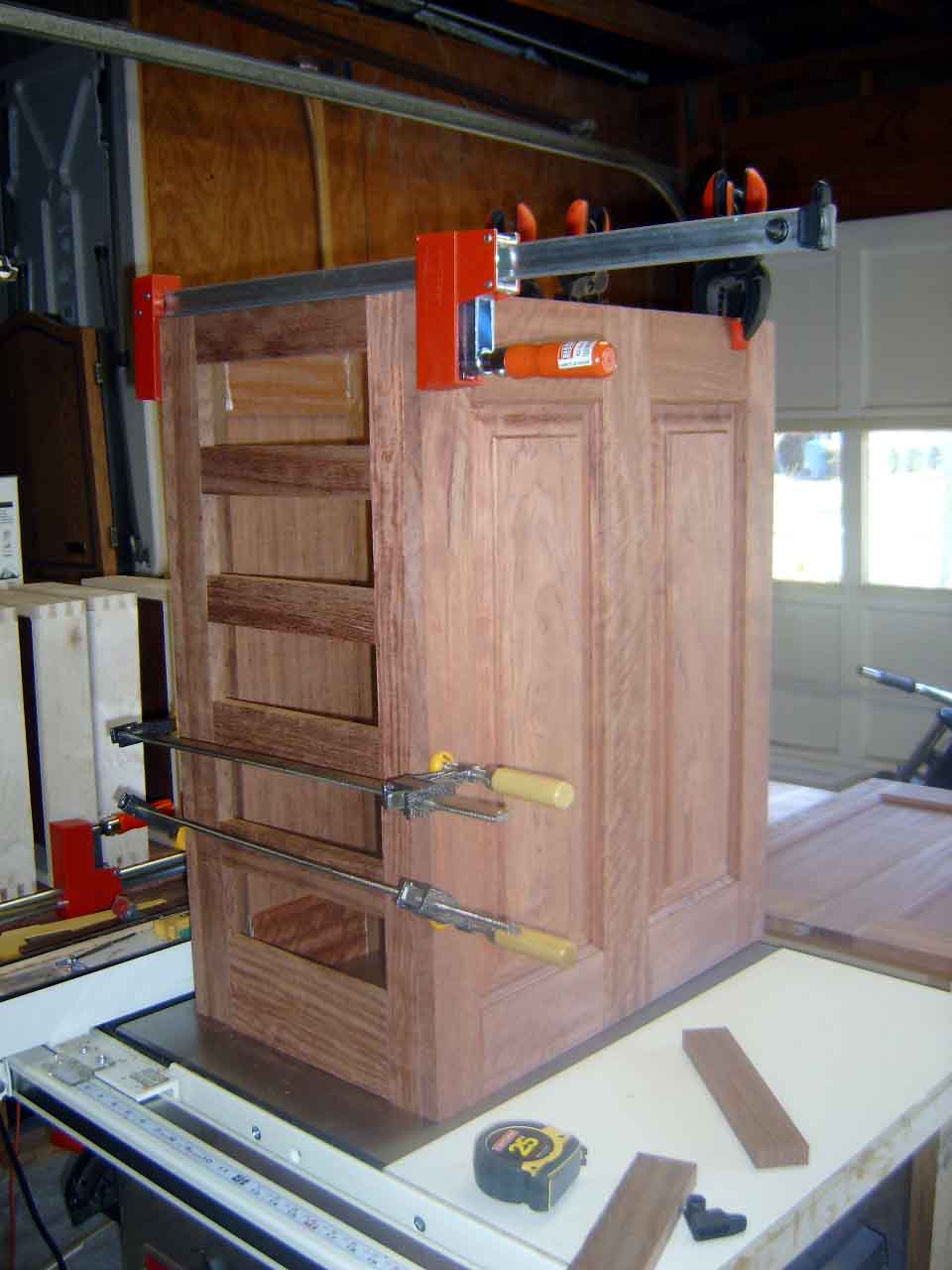

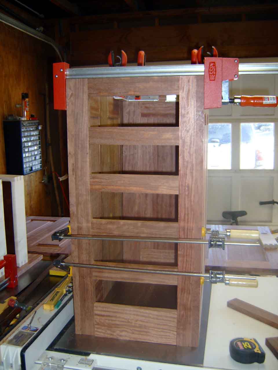

                Making some progress.

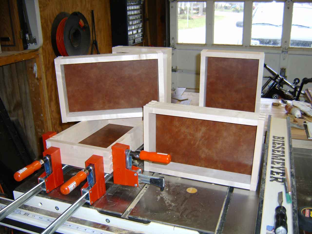

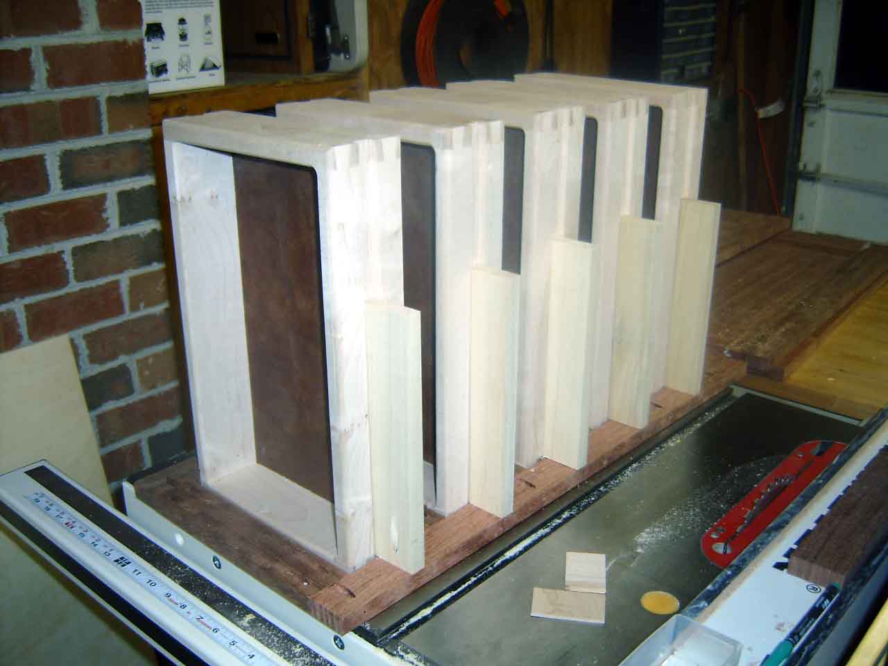

                Here are some drawers. I need one more for one side but one of the side rails came out an inch to short and I didnt notice. So when I go back to make a few for the other side I will fix that one too.
                I also have one of the flat panels done for the inside side. I need one more of those and two single panel fronts. I will probably make them flat too since they most likely will always be against the wall and its cheaper and lighter. I checked lowes and the cheap drawer slides were about gone. No small ones at all. I will either do sliding dovetails or put dadoes in the side to ride on a rail. Once I glue up all the drawers I will attack bubinga to the front but I want to build my frame first. I dont know if it will look right if I leave a gap between the drawers so I dont want to cut up to much wood yet. I was thinking about a half inch gap between each drawer. I will probably dress up the sides like the raised panel but not the full length since the drawers wont be to big.
                There was quite a bit of chip out on the soft maple and I left it a full 3/4".
                If I ran it through the planer I imagine it could tear up the ends now.
                I had two corners break off when I was making my dovetails. I should have made it 3 1/4" instead of 3". I grabbed my book after I cut all the wood. Oh well...

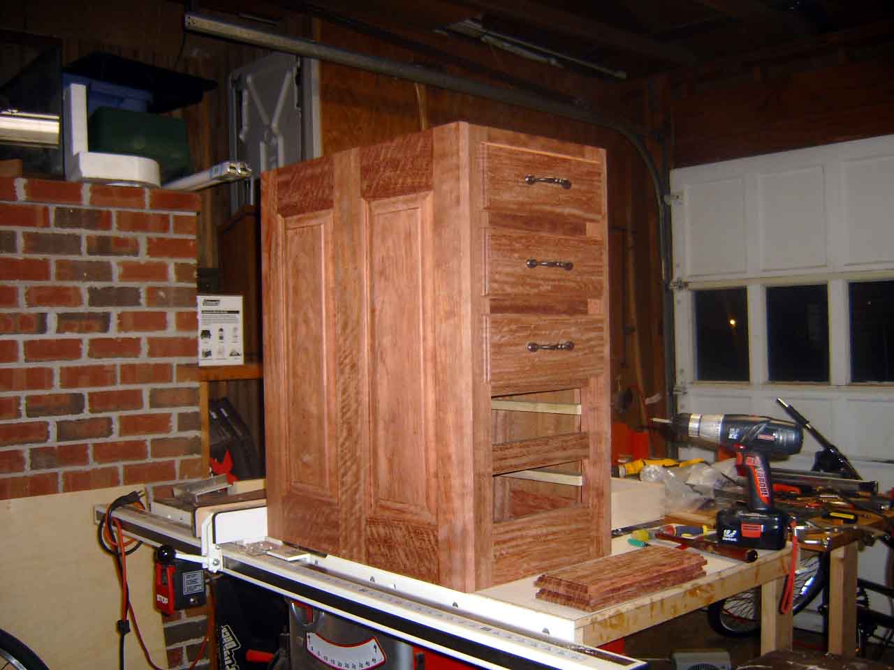

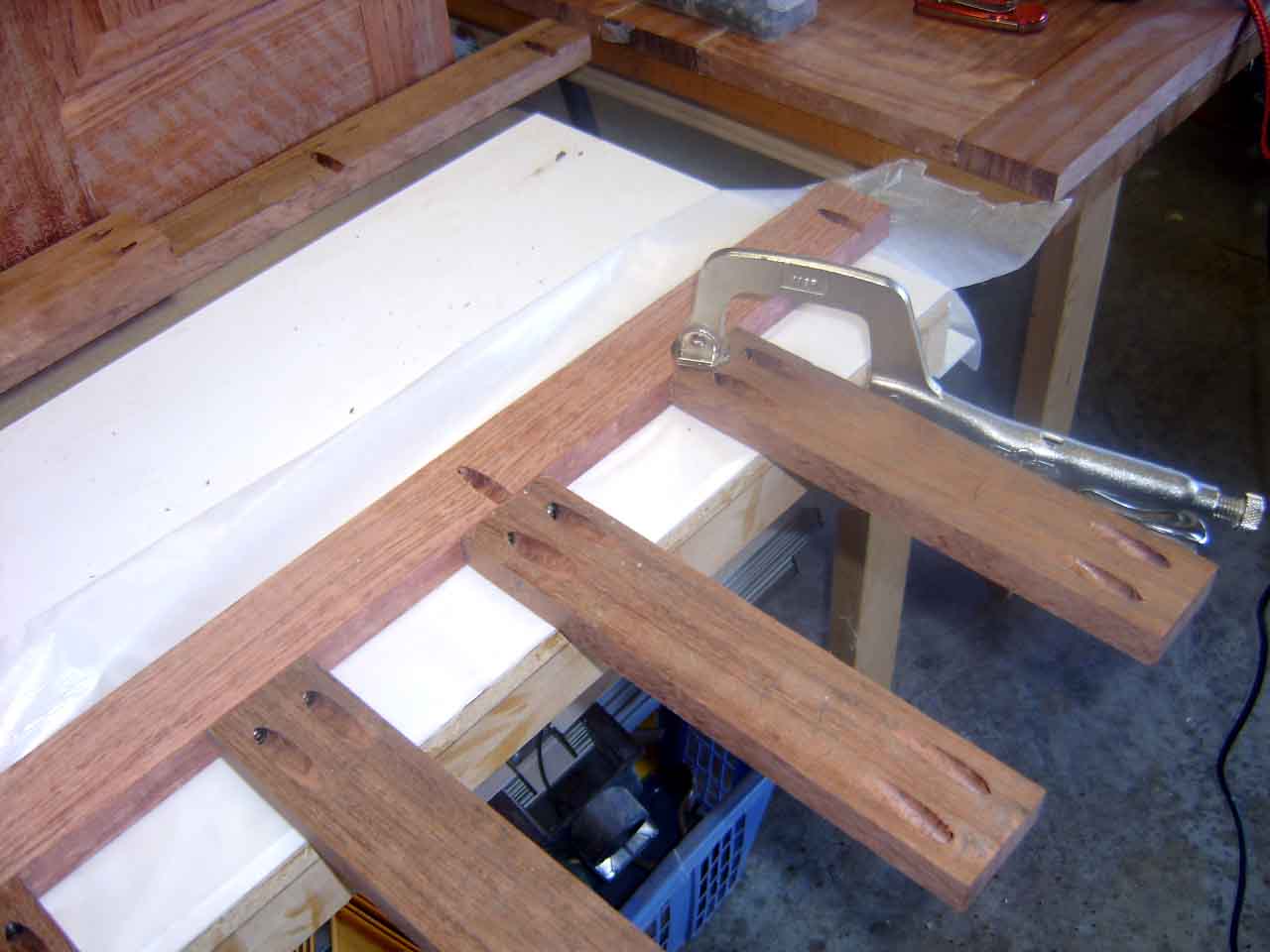

                  im getting there.
                  This piece should be done (minus sanding and finishing)by tomorrow. Had a major problem today. I was using pocket hole screws to connect the sides to the back and the screws kept stripping or breaking. Had to go buy some vice grips to get em out. Then after all that mess had me flustered I ended up putting the raised panels on the wrong side so now my drawers will be on the left. I wanted this one to be on the right side of the desk. Oh well, Guess I will have to live with it now. And since all my drawers didnt come out exactly the same I had to fit everything one piece at a time. I guess if I ever need to make a lot of drawers I might not use dovetails.
