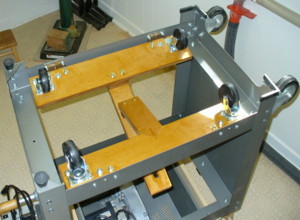

    Not willing to pay HD $194Can for a herc-u-lift, I decide to make my own.
    It took quite a while to design and build it, but I’m happy with it and it’s
    working like a charm. I’m a frugal man(some say cheap), don’t pay myself
    much, so labour was cheap.

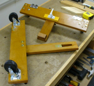

    Anyway here is what you’ll need:
    • 4, 3” swivel casters, (Lee Valley $4.20, HD $8.48)
    • 4, 3” butt hinges
    • 1/4”-20 x 1-1/4” nuts and bolts
    • 1/4” flat and lock washers
    (I bought the above fasteners in box quantity, cheaper that way)
    • 12, 1/4”-20 x 1/2”
    • 2, 1/4”-20 x 3” bolts
    • 1 screen door catch
    • 3/4 ”MDF
    You will need something to make and mount the little “striker” plate
    mounted against the underside of the pedal beam, I cut it from
    a piece of 1/8” aluminum I had in my scrap box.

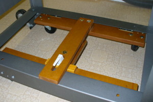

    Below are some construction comments:
    Obviously various dimensions may change if you use:
    • different casters
    • a different screen door catch
    • a different thickness of material for the 3/4” MDF
    The swivel casters I used were 3-1/2 ” in total height. You also have to
    consider the swivel radius of the casters.

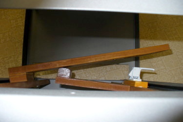

    Note that the little block, the screen door catch is mounted on, has a
    slight slope to it. This tipped the lever of the screen door catch up a bit
    making it easier to trip the catch when you want to release the pedal
    beam. It also made for more secure “catching” of the little striker plate
    when the pedal beam is down to lift the base.

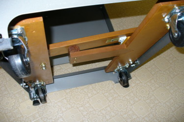

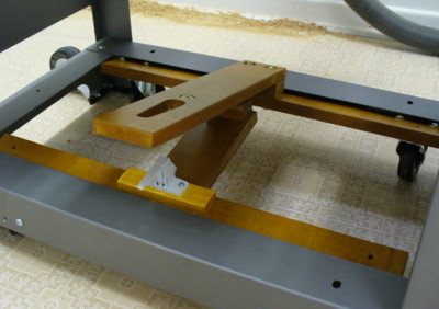

    I did not glue the 1” high pedal beam riser block to the beam the casters
    are mounted on, but relied only on the two 3” bolts. This allows a bit of
    sideways swing of the the pedal beam before tightening up the bolts to
    make sure the slot in the pedal beam lines up with the screen door catch.
    Don’t use casters which are too high or beam material which is too thick
    or the beams will hit the saw base preventing the casters from pivoting
    up high enough when the pedal beam is released.
    Don’t make the “catch beam” too long or it will not be able to come up
    high enough. I could have made mine shorter.
