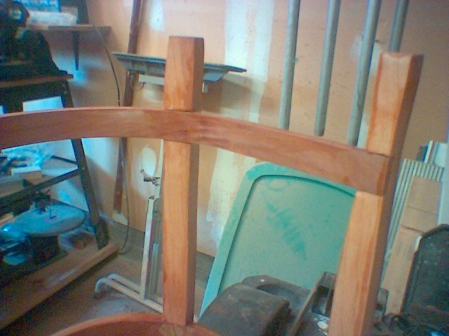

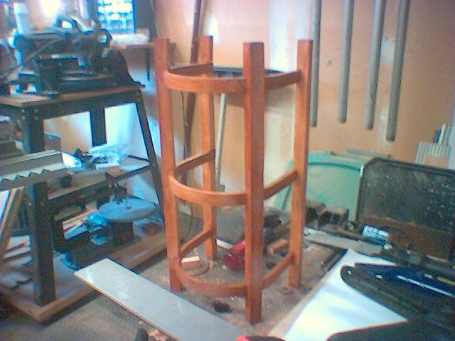

    The cut 3 horse shoes 1/2" high 1/4" wide with the round part being 5 1/2 on outside. Make some sticks 1/2 square with 1/4" dadoes cut middle and 1 inch from the ends.
    Buy more cheap spring clamps. (12 dadoes per sconce x 5 sconces).
    Figure something out for attaching them to the wall.
    Try Miniwax pecan polyshade. Hate that stuff, combines all the worst of a water based stain with the drying time of oil based poly. Next time separate steps for stain and poly.
    Oh yeah, the wood is cherry for the curved pieces and mahogany for the sticks.

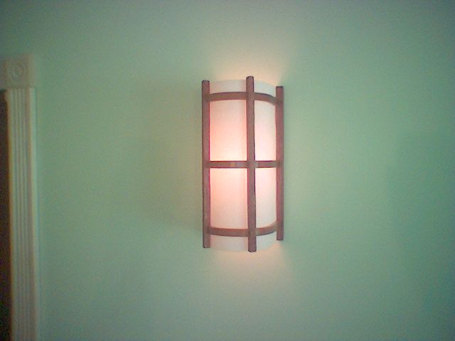

    Here are the results.

    looks cool. How did you make the horseshoe curved pieces (from a single large 6" wide piece using the new bandsaw?) and fasten the canvas?

              The horse shoes were from several pieces of 6" stock planed to 1/2 inch. Most of the pieces were 18 - 20 inches long. I had gotten 3 boxes of scrapes from a friend who works at a cabinet shop for 30 bucks. All cherry, maple and mahogany. The curved cutout parts are being cut again and made into hearts to decorate my nieces bedroom. What's left from that I don't know what I will do with but I might glue up and try my hand at a bandsaw box or 2. Now if I can only figure out what to do with the saw dust.
              The horse shoes were the excuse for the band saw but I had them done on a delta scroll saw first. Then I practiced my OSS technique getting them to be the same width.
              The items are attached toe the walls with eye hooks into the back vertical pieces and then screwed into the drywall.

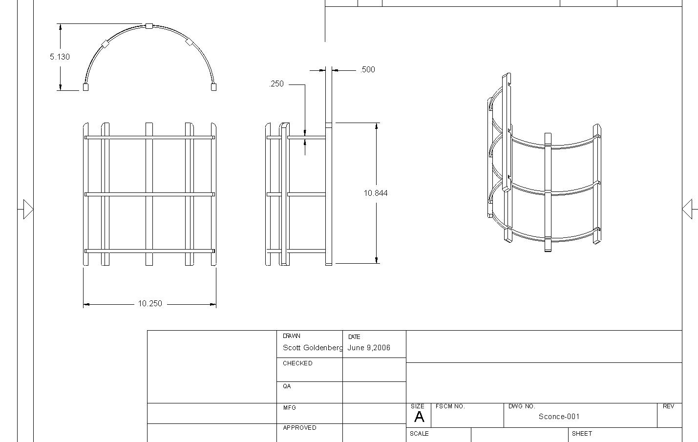

              Also do any of you use Alibre? This program is the bomb!!. I have tried just about every CAD program out there and this by far the best I have used. And it's free for the entry level version. Attached is one of the plans that Alibre created. This is a link to the version I use on their site.

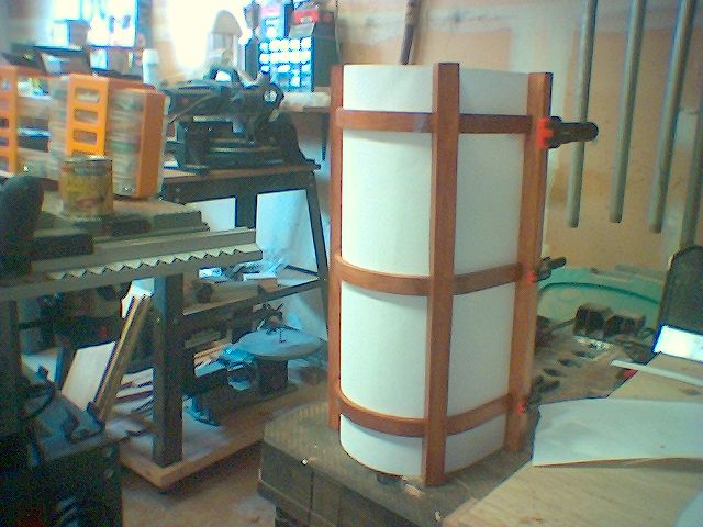

                          Very nice. How did you attached the canvas to match the curve? Double-stick?

                            atgcpaul,
                            On both edges, I used yellow glue with little bits of wood (when I am no longer a newbie - I will use fancy words like cawls) and spring clamps. For the center I used a very thin layer of yellow glue an gravity.
                            The only weight supported is the canvas it's self so there was not real need for much else.
                            Since the canvas is somewhat asorbitive, I guessed the yellow glue would seep in an make a good bond.
                            Only problem with this is that I think I might be becoming a clamp addict. I allways seem to need just one more clamp.
