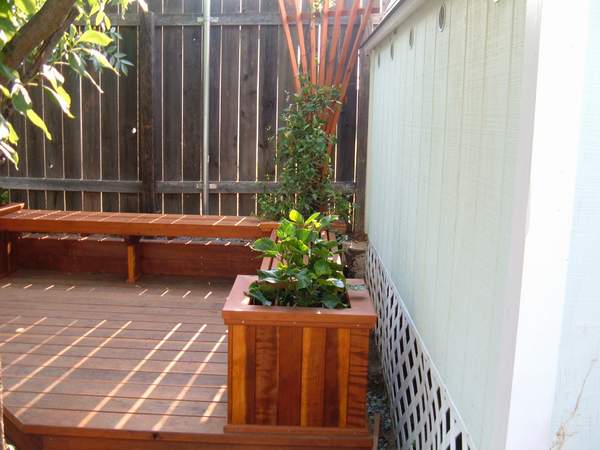

    If you can call this little thing a deck, that is.
    My wife wanted me to do some thing with the corner by the shed so it wouldn't have to be mowed as it was nearly impossible to get the mower in there. So I put a redwood deck on it. It's small but useful. The trellis in the corner is a 2x6 piece of redwood slit on the table saw and spread to the size we needed, stabilized with the cross pieces. (easiest way to build a trellis) Hopefully, the plant will cover it and cover the unattractive area behind the shed.
    The planter boxes and benches were an after thought. Obviously, the landscaping around it still needs to be done.

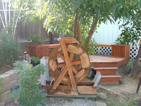

        Like Storm said, it could be a nice little place to get away! Did you build the water wheel?

          Little thing? Absolutely beautiful! Love the waterwheel!

                      Very nice work. The water wheel is a nice touch.

                        Excellent work. My son is building a Coy pond. I think the water wheel would work very well with what he has in mind. Any details on that part?

                            Looks great, wouldn't mind having that here if it weren't for our state bird (mosquitos)! I remember the water wheel thread, nice to see it in context!

                              Pappy, yes, I did build the water wheel. It was about a year ago now that I posted that one but I guess the thread got lost. It isn't there any more.
                              Lee, I built the water wheel from a plan I got off the internet. But since I've seen those plans at Lowe's and Rockler. I made mine out of cedar. If you are going to build one, I would recommend that you get stainless steel hardware for it. (shaft, bearings, etc.) My bearings gave out after only 8 months and the shaft rusted. (A kit I got from the internet) Now it is running on brass bushings and a stainless steel shaft.
