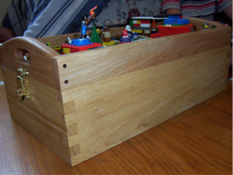

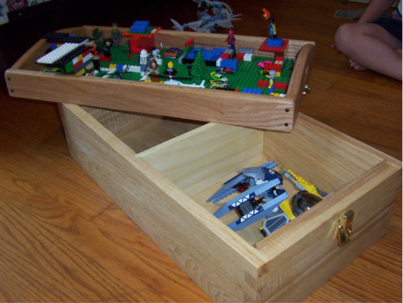

    Two boys that love LEGOs have birthdays this week. So I decided to build a tray with green baseplates that attaches to a chest for storage.

    The tray is red oak, the case is ash. There are brass locking latches on the ends to protect special projects inside from destructive brothers.

    I took the opportunity to pick up the Miller dowel miniX at Rockler & put walnut dowels in the tray butt joints to jazz it up a little. This was my first time using box joints in a project. They were made on the TS with dado set & homemade jig. The finish is a few coats of wipe-on poly.

        Very nice! Looks like you could even expand it upward as their collection grows (and it will! )

              The tray with the Lego base is a great idea.

                  It came out great, nice finish, and the joints look really good. You're hooked!

                              I really like that idea. And the boxjoints look great, also.
