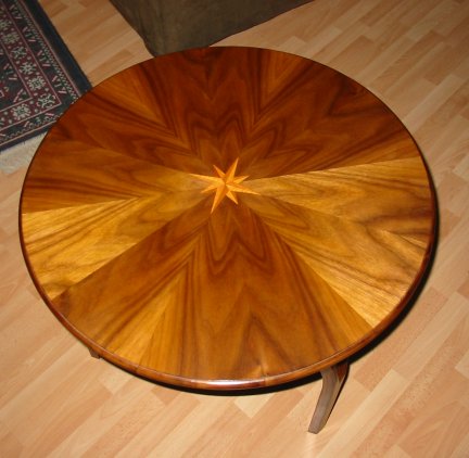

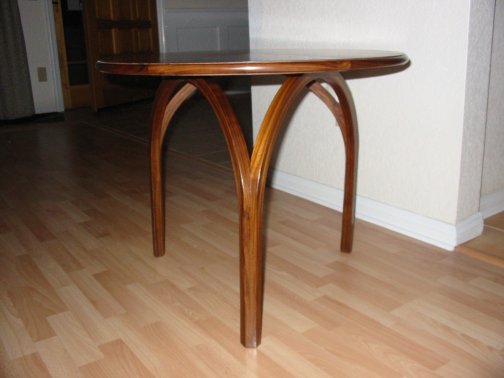

    Well, I decided to combine the sunburst top and bent wood project into one
    piece. What you see is a design borrowed from the Thos. Moser catalog
    called the Vault Table. It's a 21" tall occassional table with 3 identical arched
    legs. I built an MDF bending form, resawed walnut to 1/10" thick, and laminated
    them together using plastic resin glue.
    The top is a 12 piece walnut sunburst layed up on an MDF core with a solid
    walnut surround. After gluing down the veneer using my homemade vacuum
    veneer press from Joe Woodworker, I made a router trammel to cut the 26"
    diameter top.
    The finish is boiled linseed oil followed by shellac and then wax.

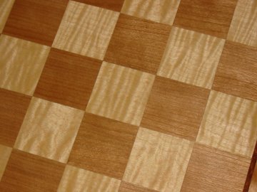

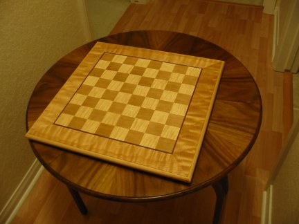

    The checkerboard is 1 1/2" squares of straight-grained cherry veneer and
    curly maple veneer.

    very nicely done, I especially like the table.

                            Great looking work! I love the idea of combining cherry and maple for the chess board! The border around the chess board, is that also curly maple that you stained? Did you stain the cherry? What is the very dark stripe in the board?
                            Thanks
                            Gerd
                              Wow. That is some beautiful work. I love that table and the sunburst design on it.
