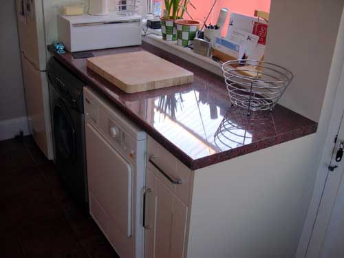

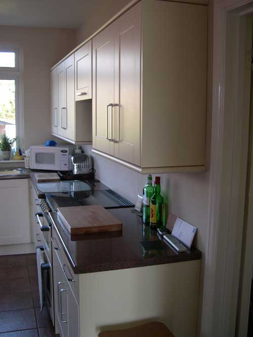

    I've recently installed a kitchen for a former employee - nothing too difficult, and some nice hardware from Hafele (I made the chopping board in the first picture out of some left-over solid beech IKEA worktop from another job).

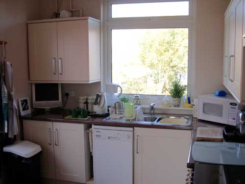

    The cupboard around the wall-hung boiler was a bit of a pain, otherwise, no problems.

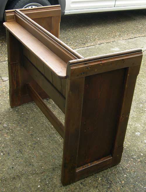

    When I'd finished, I collected just under half of a 15 foot church pew. Her mother had bought it "to split between her son and daughter" and her husband had taken a saw to it! The son collected his half in a trailer and the left-hand side is propped up on books. It'll probably stay that quite a while! Anyway, my friend wanted a "proper job" doing to make a "two-bum seat" out of it for use in the mud room of their French cottage.
    I carefully took it apart (dowelled mortice and tenons mostly) and had a think. There was no stock as thick as the existing end, but I had just enough seat to make a panel, rebated into the rest of the timber. Here's the result:

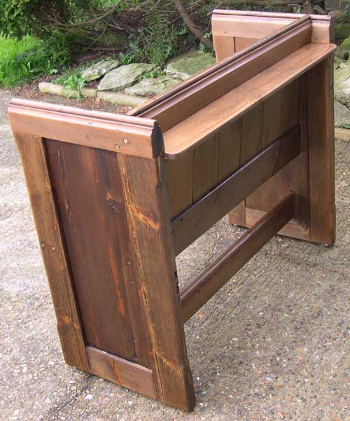

    I even cut down the prayer book shelf to match. You can see the original end in this shot, the next picture shows my version, with extra stock added to gain a bit of depth - not quite as much as the original, but you'd be pretty clever to see both sides at once, so I reckon it'll do.

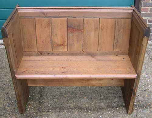

    The whole thing was sanded then re-stained to ensure that the raw edges weren't too obvious. Not perfect, but I think it's better than a stack of books!

          What’s your opinion of those Ikea tops Ray? I had seen something posted in another thread either here or somewhere else on those and I have been thinking about the different uses for something like that. I understand they have a warp in them, is this true? If so how much?
              Ken,
              My experience of the IKEA tops is through fitting six in one kitchen (details here). All were perfectly flat and true. The experience of onedash was unfortunate, but my small sample seems to show that they're normally fine. They're made of beech staves, glued and finger-jointed together. I'm NEVER going to install one in my kitchen, as they dent at the slightest touch - for example, dropping cutlery from about 6" leaves a mark - as the client knows only too well! They're heavy and - if sealed or oiled both sides - should be very stable, but the surface would last about five minutes in any workshop, unless a sacrificial top was added. HTH

                Thanks Ray, I was thinking about perhaps coating with a Polycrylic or an Epoxy finish. Currently I am toying with the idea of a bathroom remodel using Maple for all the cabinet faces and Birdseye Maple veneer for the drawers and door faces. I was thinking that something like this would be a good medium contrast for a sink top if sealed properly. I would have to think about the coating as you mention the beech is soft.
