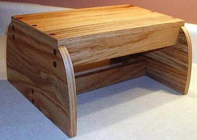

    Here's a simple step stool I made for my munchkins. Joinery: tbII, screw and plug. Materials: red oak, 3/8 hardwood dowels and oak veneer to cover end grain. Finish: 8 coats of tung oil (thinned @ 50%) and wax. Total cost : $11 for the cost of a toggle clamp for a biscuit joinery jig I made in the process. Everything else I had on hand including a couple hundred bf of red oak I was recently given.

    Sharp-looking, and I bet that big base makes it stable.

      Pretty cool design. Nice work.

        Design has possibilities
        That is an excelent design!
        If it's YOUR design, you might want to get a set of drawings made and see if it can be offered commercially, or at least published in one of the WW Mags.

          Nice looking work and the design is great. I may have to copy that.

            Sounds like a hidden gloat if you ask me! Nice step stool BTW
              Very nice.

                Very nice job.

                  Nice work. The veneer on the end grain is a nice touch.
                    Looks good and it should get plenty of use.
                      Nice design, smooth finish and the workmanship looks perfect.

                        Like the others, I think that is a great design and build was very well done.

                          Looks handy. Congratulations!
