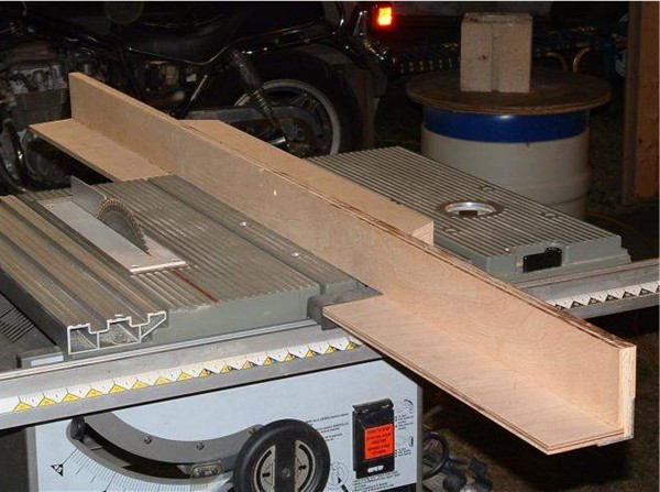

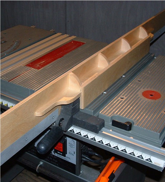

    I remade long fence attachment using 1/2" Baltic Birch, finished with 2 coats of precatylised laquer.
    The long fence attachment is to give additional infeed and outfeed support as well as a longer fence. The pads are reinforced with 1 1/2" x 1/8" aluminum angle. I still need to drill the right side so a T nut can be used to prevent it from rocking when the weight is on the infeed or outfeed support.
    This is the first version.
Name:	Long fence.JPG
    Changes include a taller fence section, larger infeed/outfeed pads, and better bracing for the fence and 'h' assembly.
Name:	Revised Long Fence.jpg
Name:	Long fence back.jpg

    Great! Another project for my "must do" list...
    Gary J. Bivin
    Gilbert, AZ
    • monte
      ***** Windbag
      • 5242
      • Paw Paw, MI, USA.
      • GI 50-185M
      Very nice work Pappy. That should work very well.
      Monte (another darksider)
      • Scottydont
        • 2359
        • Edmonds, WA, USA.
        • Delta Industrial Hybrid
        Looks great Pappy!
        Scott
        Edmonds WA
        No coffee, no worky!
          I like this! Nice job.
            I want one!
              Nice job Pappy.
              • Tom Miller
                • 2507
                • Twin Cities, MN
                That infeed/outfeed support idea (and execution) is just awesome! If/when I redo my fence, that's goin' in.
                Regards,
                • Scot
                  • 34
                  • Ottawa, Canada
                  • Ryobi
                  Excellent. Great idea. I want one too.
                  Art
                  • jdschulteis
                    • 139
                    • Muskego, Wisconsin, USA.
                    I was thinking about doing much the same thing, but only for the infeed side.
                    I'm glad to know that it's a workable approach.
                    Jerry
                    • ryan.s
                      • 785
                      • So Cal
                      That's an excellent idea. Another one for my "to do" list.
                      • SHADOWFOX
                        • 1232
                        • IL, USA.
                        • DELTA 36-675
                        Excellent fence! Thank you for posting, I've been trying to brainstorm a design but this one i think would fit the bill.
                        Chris
                        • Crash2510
                          • 830
                          • North Central Ohio
                          I think I will put this on the top of my to do list
                          Phil In Ohio
                          The basement woodworker
                          • JeffW
                            • 1594
                            • San Antonio, Texas, USA.
                            Well Don, that looks right nice. Looks like it will fit my saw also. Just throw it in your truck next time you come down..........;
                            Measure twice, cut once, screw it up, start over
                              Jeff, the original version, minus the aluminum angle, is still hanging on the wall....
