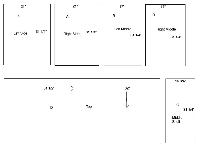

        Here are some rough dimensional drawings.

          Now, the reason I made it this tall was that I am 6'6" and needed the extra height, plus my scroll saw was just under 17" tall and barely slides into the cabinet. I added a portion of some new rails (I have 13" sections front and back rails left over) which necessitated making the cabinet that wide. The torsion box is made with plywood to a total height of 4" (2 1/2" dividers). I'll add more photos when I get my end supports built and mount my router. I now need to figure out how to make a router table. Any suggestions??? I did take Ray's recommendation with the Triton router. I got it yesterday and just had to test it out right away. WOW!!! so easy to use, and nice clean cuts.

            Great job, Brian!! Thanks for the plans!

              Thanks for plans ;!)
