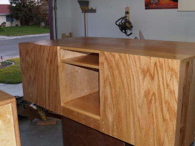

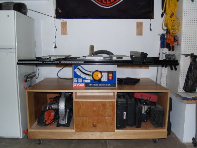

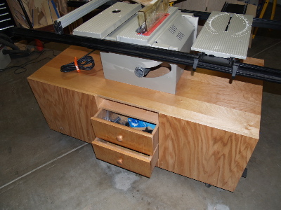

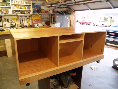

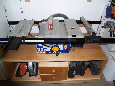

    I was undecided when I first spotted one at the BORG. Running a Google on the BT3K led me here. With all the great reviews and info I picked one up and couldn't be any happier with my purchase.
    The first project I made was this Mobile cabinet. I started with a torsion box, then for the cabinet used biscuits to add strength to the joints. I've used biscuits to assemble a prior project and it worked well. The center dividers were spaced to place the BT mount bolts outside the vertical dividers. This gave me a decent size for the drawers and space to route out the middle for my dust collection bin. I made the cab plenty deep to prevent the saw from tipping when cutting large boards like my old Craftsman would. This had the benefit of adding weight to the unit for stabilty. Seems to work well. I am adding leveler feet to the sides and am looking to add a router station and table top. Any comments or ideas would be appreciated.
    Thanks
    Brian

            That first picture looks more like an entertainment center than a mobile
            cabinet, but I suppose the BT3K is an entertainment center for most of
            us. Nice work.

                        Yeah, after I assembled and coated it in Poly, I was thinking it would look great as a tv stand or something inside the house. I guess I figured that I might as well take my time and do it right. I think it took me about 2 weeks before I even got the saw mounted (that only took about 20 minutes). Lots of planning and looking around the internet for ideas before I even got around to buying the wood. I used some leftover 3/4" red oak ply for the torsion box and on the back and 3/4" birch ply for the rest. I'm not too impressed with the 4" wheels I bought at OSH. It is kind of hard to get to the locking lever.

                              Great job! Well thought out and built. Just one question. What is the plan for the space directly under the saw? Dust collection?
