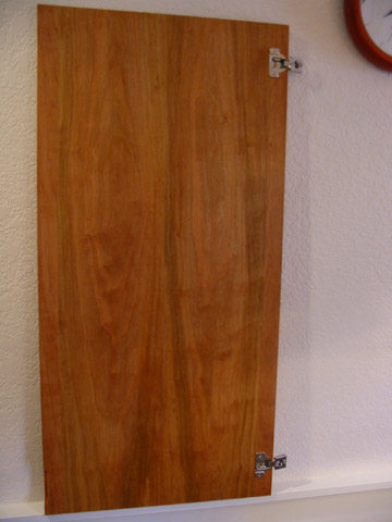

    My neighbor loves wood. Almost more than me but his tastes are very
    eclectic. Anyway, his house is a hodge podge of styles but it is tasteful.
    Well, to add to the frenzy he asked (bugged) me to build him some doors
    for his linen closet. I picked out the lumber (2 cherry boards) and he paid
    for the material. He paid me for labor []
    I was hoping he'd want a frame and panel system because I worried about

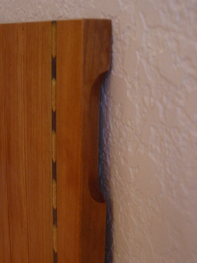

    cupping. He opted for a slab door. Since he wanted grooves routed down
    the length of the board, I ripped the board into 2" strips, jointed the mating
    edges with a handplane and kept them in sequence so the grain looked
    consistent. On the big door (19"x39"), the board had two "eyes" in it so it
    actually looks a little bookmatched. He also bought a strip of inlay for one
    edge of the doors.
    The doors were put together a few weeks ago and are still flat. I'm crossing
    my fingers that I won't have to use strongbacks. I did goof in routing one
    groove on the big door. I hope it isn't too noticeable.
    So cherry wood (my first time), thinned out/rubbed in BLO, several coats of
    shellac, rubbed out, then waxed.

    Look good, Paul. Cherry is great to work with!

      Very nice.

        Good job and that's great looking cherry!!

          Looks great! I don't know if I agree with Pappy, however, about cherry being nice to work with. I like it but it seems to burn easier than oak which I guess is my favorite. It does not chip out as bad, however. The other thing I don't like about cherry is the cost - in this case that was somebody else's problem.

            Are you trying to sneak in an updated look at your wainscott in addition to the new doors?
            They look great! (doors and wainscott).

                Beautiful work and yeah that Cherry is pretty. Great job on the finish too I might add. I think the guys got pretty good taste if you ask me and looks like he picked a capable woodworker.
