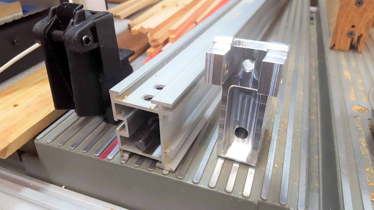

              Rear clip? The black plastic piece on the far end called a roller holder and tends to break after 20 some years.
              There are machined metal ones on eBay.
              you can either buy the block itself and move the roller and the pins and clamp etc or you can buy an entire assembly.
              These blocks are aluminum and will probably never break.
              I bought a replacement aluminum machined roller holder and its been working for several years on my BT3000, Same part fits all the clones, I believe.​

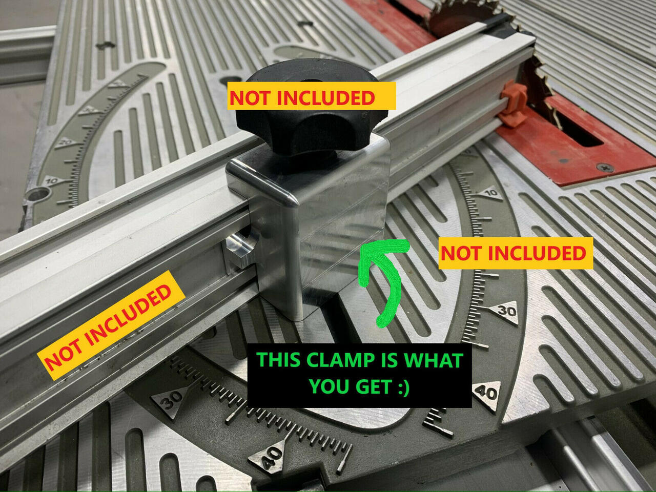

              Loring posted pictures of an aluminum roller block available on eBay. On eBay, there WERE two very special Aluminum replacements for the BT3x00 that are very helpful to have for the long run in using the 3000 or 3100. The above post is the rear block housing. The other aluminum replacement is for the Sliding miter table's Miter fence holding block.
              Those two items are prone to breaking on occasion and having the higher priced aluminum replacement sure is worth it. I cannot find the miter fence holder block in Aluminum on eBay now, but if you find one, it might be worth it. Of course you could make your own as shown in this link, post # 10 https://www.sawdustzone.org/forum/di...ege#post853443
                • 22012
                picture of the miter fence holder Lee mentioned. Don't break that often. I would not upgrade. Still using my original
                Click image for larger version  Name:	eBay metal miter fence holder replacement part.jpg Views:	0 Size:	219.3 KB ID:	853449
                Here is the old plastic rip fence roller holder on left, the rip fence extrusion (upside down) and an eBay machined replacement on the right. All are upside down.
